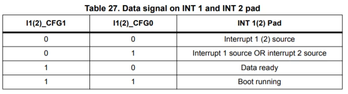

Hi @PGoud​ ,
is it only the DRDY interrupt that is not working in your application, or also other interrupts (the ones generated from mechanical events)?
I suppose you already tried configuring the CTRL_REG3 [interrupt CTRL register] (22h) for the Data Ready routed on INT1(2) pad (datasheet, p.27):
0693W000008z5vaQAA.pngYou could try to enable the LIR1 bit and see if the interrupt is working at leas in latched mode.
You can also try to set 01h in the INT1_DURATION (33h) register.
-Eleon

Hello Eleon,
Basically, DATAready interrupt works well for me, no problem about configuring it, it's ok.
My exact problem is that do not success in making it working as a "Free" "Pulses interrupt".
I mean I would like to see the INT1 line making "ON/OFF/ON/OFF/ON... without needing to "read acceleration" after each edge. I already tried the "Pulse" configuration" and even set the INT1 duration to 1 or 0 but It seems to be always mandatory to "Read accelerations" to "release" the current state of INT1 Line ...
So, can you tell me if there is a way to let DataReady interrupts run in kind of "free run" (one pulse after each sample) without any more action on the H3LIS331DL after it's configuration ? ... Maybe it's not possible ...

Hi @PGoud​ ,
I've understood better your question only now...
I'm afraid it is not possible to run the DRDY signal as a "square wave" at ODR frequency on H3LIS331DL, you also need to read the dataout in order to refresh the DRDY.
It might be possible in the products that have a dedicated INT for the DRDY signal, such as the LIS2DW12, but I'm not sure...
