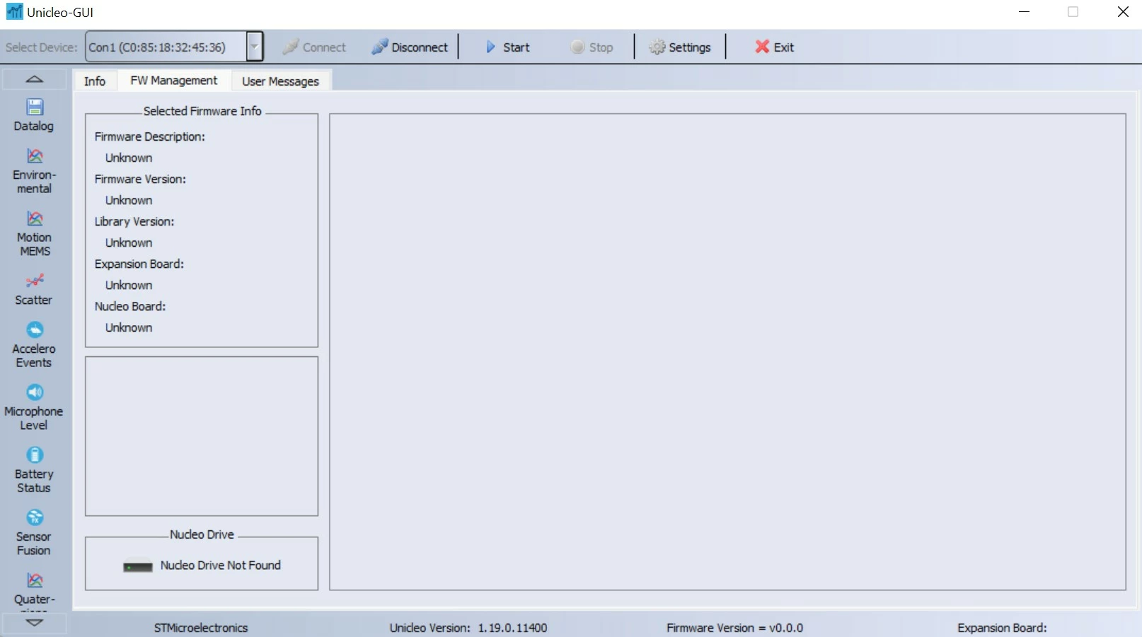

SensorTile KIT connection with Unicleo on Windows 11 Fail.
Hi, i am trying to connect the SensorTile kit STEVAL-STLKT01V1 over bluetooth with Unicleo GUI. While I have paired the device with my PC, unicleo is unable to find the device. I can see the device in the selection device section (COM) but all the information are unknown or unable to read them. Also with USB it is invisible as device. Has anyone encounter a similar problem? Are windows 11 ineligible for this kind of connection? I want to collect data from all the sensors but when I am connecting the device with the mobile app ST BLE Sensor I can't find an option to get data from the microphone so Unicleo is way better. If there is any other way to collect all the data please feel free to share. I am trying to connect this device for a long time now and I am facing only problems.

Hello
I'm sorry to hear that. Could you please answer a few following questions:
  • What firmware exactly do you have in your SensorTile?
  • What is the name of the device after pairing in Windows?
  • Do you see new COM ports after your pair the device?
  • Does it require PIN code during pairing process?

Hello, Thanks for the fast answer.
Firmware: FP-SNS-ALLMEMS1 Version: 3.3.0 MCU Type: L476
Name of the Device: Con1
In the selection device dropdown list i dont see a COM i see the Con1 which is via bluetooth. I don't see any COM. (Was a mistake to mention that.)
Pin: Yes, it does require a PIN which is 123456.
While i pair the device, the red light on the device is not blinking nor is on. Only the green is on. On the other hand, while i connect the device via the Smartphone app, the red light stays on all the time.
Unicleo-GUI Version: 1.19.0.11400
This is what it looks while the device is paired and connect is pressed.
May 6, 2022
There is missing control tab in the Unicleo-GUI, most probably because the name of the device is different than expected. Didn't you change the the name. I think it should be AM1V330.

louda.marian
May 9, 2022
Hello, this is a strange behavior, because the default name should start with "AM1V" followed by version number. Are you using the binary from package or did you compile your own binary? Attached is binary from package 3.3.0 which is functional under Windows 10. Windows 11 is not available, so I cannot confirm the functionality. Please try to program your SensorTile with attached firmware and try it again, this should reset the name to default value.
