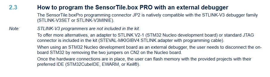

Hi, I purchased the SensorTile.box PRO sensor, but I can't develop because it doesn't connect to the STLINK V2-1, in the datasheet it says:
I connect adapter STEVALMK1 (that was inside the kit) with STLINK V2-1

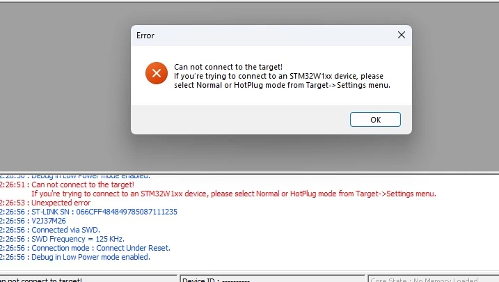

But I have the following error

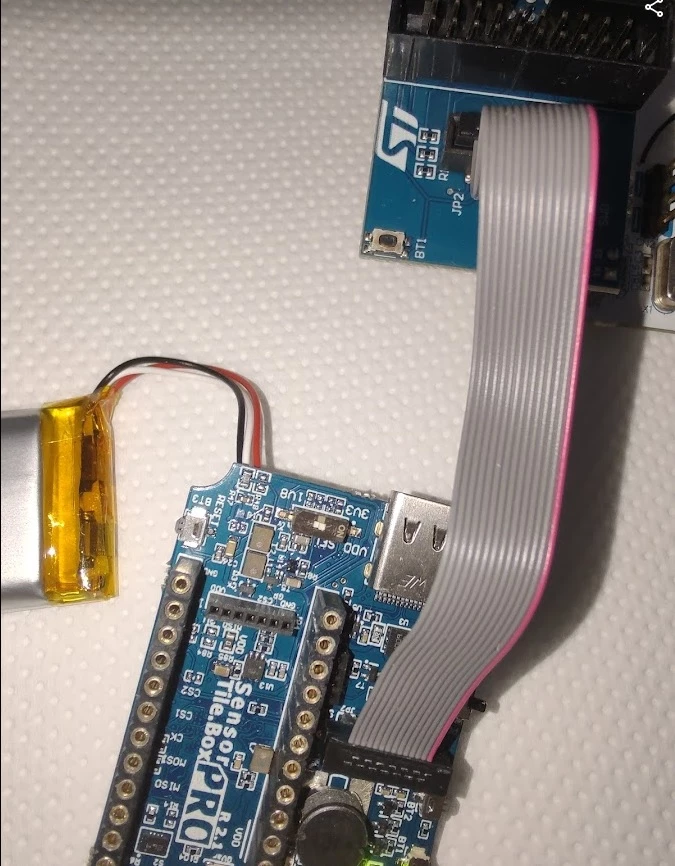

Hi @michelemancini2 ,
May I ask you for some photo of the connections (STEVALMK1+STLink+board) and the version of STMcube programmer?

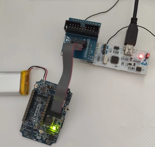

If I use the latest STLink firmware, I use STLink of the "Nucleo F401RE". In the datasheet it says that it is possible to use stlink from the Nucleo dev board.
This is the connection

Cannot you see that the ST-LINK Utility is deprecated? Also update the ST-LINK firmware!

As said by @Piranha is correct. I suggest you an update of ST-LINK, driver update and an update of cubeprogrammer. Then disconnect and reconnect all.
