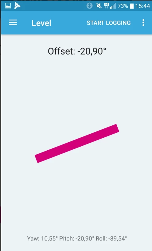

I am planning to use IMU ASM330LHB for my project and test the sensor functionality using board STEVAL-MKI236A.
I want to know whether I can plug STEVAL-MKI236A into the DIL24 connector of the SensorTile.Box PRO and test the functionality using SensortTile.box smartphone app ST BLE Sensor
https://community.st.com/mems-and-sensors-62/getting-started-with-sensortile-box-192
I want display the below values as mentioned on the link.
Is it possible?

Hi ​@Sucheta ,
The demo Level is only available for the embedded accelerometer so you can try it without any external adapter. Also STEVAL-MKI236A is not supported as an external sensor.
