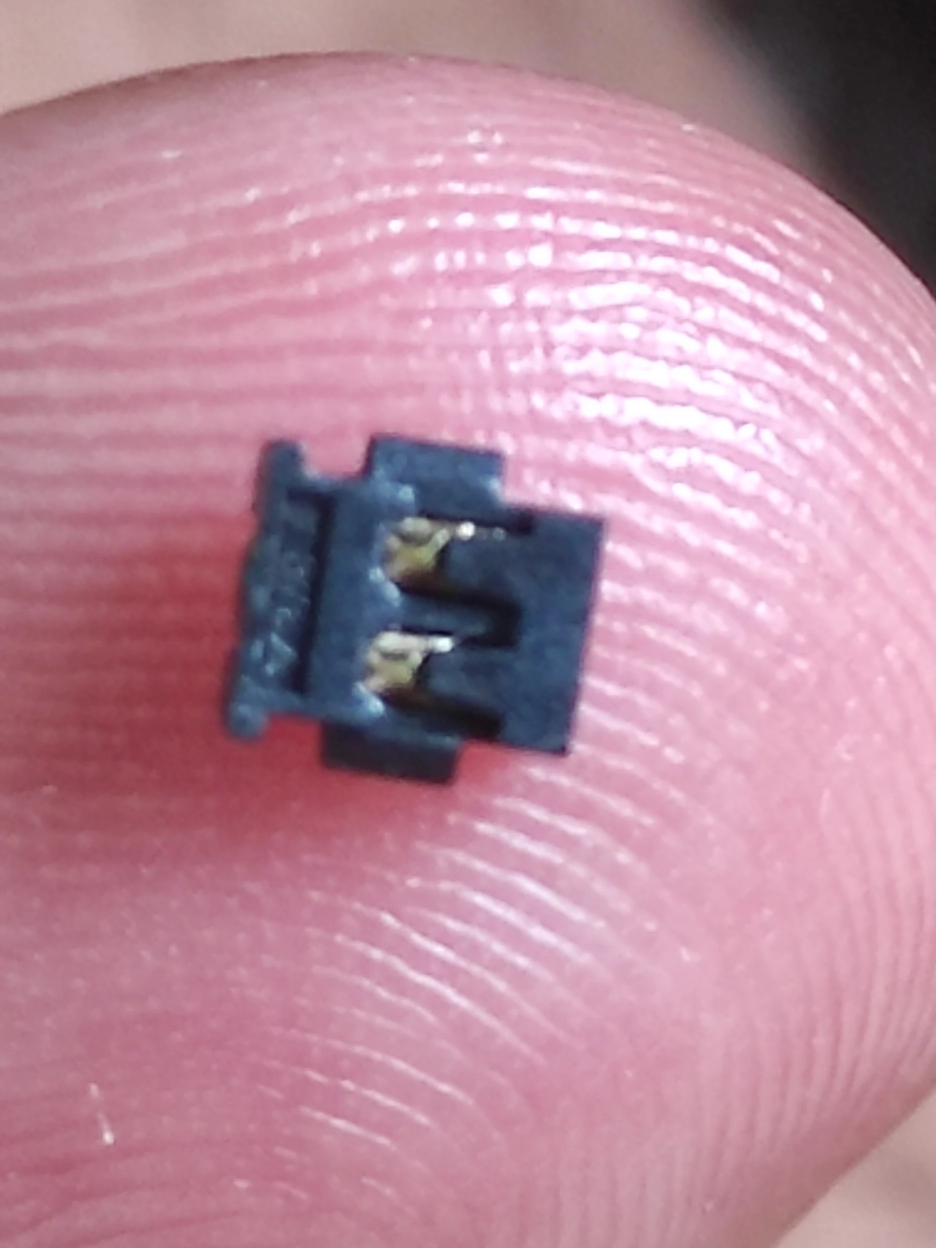

    I had one more question to ask , why does sensortile keeps disconnecting with bluetooth? while plotting graph , the graph appears for 5 seconds and then ST sensor BLE app stops plotting and whole sensor app hangs. the sensor tile box crashes and becomes un responsive.
    I would also like to know the model number of sensortile box battery connector, since the wire has ripped off the connector due to repeated handling.

    I'm very sorry that your battery connector broke, the part number is PS-78172-0002, but I would suggest to resolder it to the wires.
