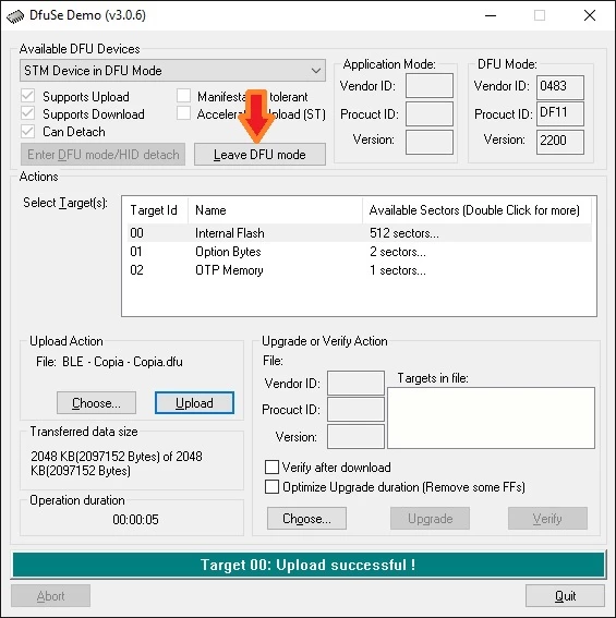

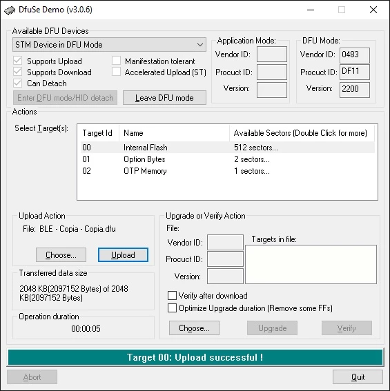

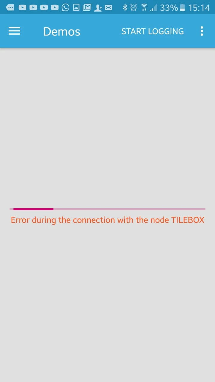

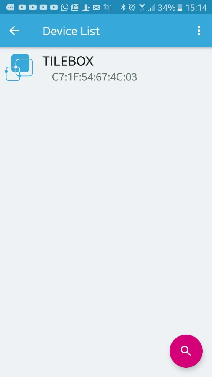

    0690X00000ArWU9QAN.jpg0690X00000ArWU4QAN.jpg0690X00000ArWTuQAN.jpgHello Eleon,
     I downloaded en.FP-SNS-STBOX1_firmware file and generated dfu file (52Kb) from BLESensors.bin . DfuSe Demo app detected the device (STM Device in DFU Mode). So I clicked "Choose..."button at box "Upload Action", and when I selected the dfu file, I receievd a message asking if I would like to overwrite the dfu file (!?). I confirmed the overwrite, selected Target Id 00 - Internal Flash at Targets windows and then uploaded, but it still not connecting with ST BLE android app. I tried to write to targets IDs 01 and 02 as well with no success. What more can I do ?
    Kind regards
    Ricardo Urio

    0690X00000AriRMQAZ.jpgHi Ricardo, did you release the dfu mode after downloading the bin file, by clicking "Leave DFUmode" button?
    About the 2nd and 3rd pic you are showing, are you able to find your device TILEBOX in the BLE list but you are not able to connect it, right?
    Regards

    "...are you able to find your device TILEBOX in the BLE list but you are not able to connect it, right?"
    A:It's right, app shows TILEBOX but don't connecto to it

    Hi Eleon,
    The problem is solved. I uploaded the .dfu again, but only using "Upgrade" button from "Upgrade or Verify Action" panel. Before, I used "Upload" button too. Now I didn't touch on it and worked fine.

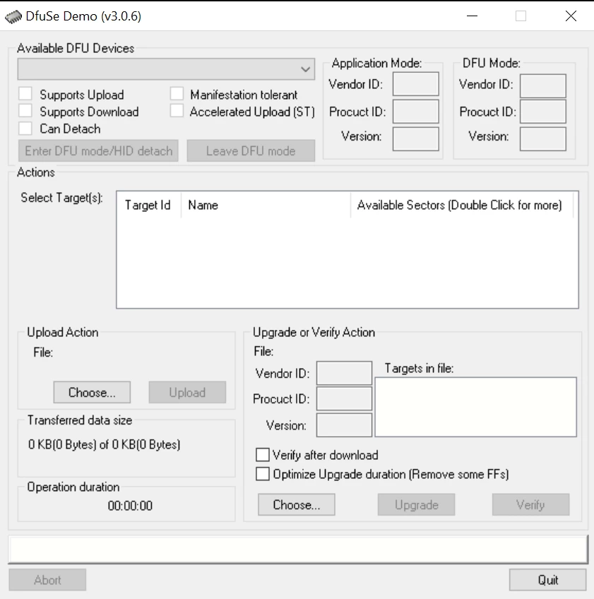

    I have similar problem, I really don't know what happened. I haven't been able to detect my sensor for 2 days.
    I used to be able to detect it in the Tera Term, now the port can't be detected, at all when I pull out and insert the usb cable, windows doesn't recognize the change...
    I've tried to retrieve the clues from this side, but in Dfuse can't choose anything. See image.

    Eleon BORLINI
    March 31, 2020
    Hi @Community member​ , pls check also the DFuSe demo drivers are not conflicting if you may have installed the STM32CubeProgrammer. Regards
