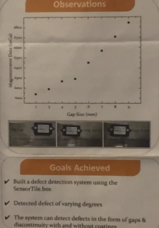

This week the winning ST.box applications of the IEEE International Contest of Sensors & Measurement Systems in Montreal, Canada, have been awarded.
  • 1st prize application: detecting defects in steel sheets using magnetic flux generated by the ST.box magnetometer. Details are shown in the picture and in the comments below.
