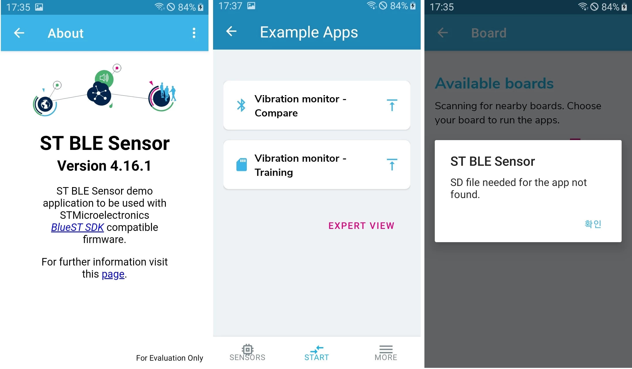

SensorTile.box Demo App - 'Vibration monitor - Compare' isn't working.
For the test of 'Vibration monitor' in the SensorTile.box example apps, I made data with 'Vibration monitor Training' and tried to test 'Vibration monitor Comare', but an error message 'SDfile needed for the app not found' appears and I can't run the app.

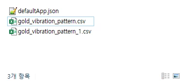

in USB virtual disk, There are files logged by the App 'Vibration monitor Training'
