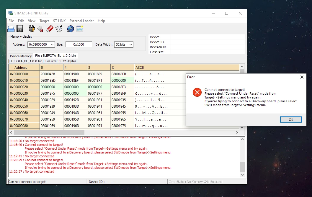

Hello
i am trying to program my sensortile.box in pro mode. I have everything I need to be able to upload binary files (JTAG adapter, ST-LinkV2) but I encounter this error. Can anyone help me?0693W000003Bhv9QAC.png

    Eleon BORLINI
    August 28, 2020
    Hi @GCele.1​ , I suppose you have solved now... ;) I suggest you to use the STM32CubeProg instead of the ST-LINK Utility to communicate via STLINK, but you can btw do a chip erase and then reconnect it. Regards
