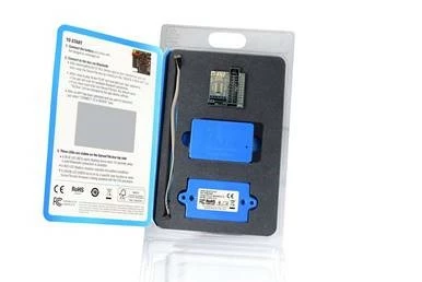

Hi!
I found a thread that says thtat the ST-LINK/V2 can be used as in circuit programmer.
SensorTile.box firmware OTA function restore documentation says that the programmer, a  JTAG adapter board V1.0 and a Flat cable to connect JTAG adapter to SensorTile.box is needed.
The SensorTile.box user manual says in chaper 3.3: "... and the most recent release of the Sensortile.box includes an adapter board and cable for the ST-LINK/V2 programming and debugging device."
I ordered two devices of the SensorTile.box but there was no adapter or cable included. Can you give me information where to get those? I could not find them anywhere as separate parts. Are they part of the STLink/V2 package?
And another question: There is a UART for debugging purposes on SensorTile.box pins available. Can I use the STLink/V2 directly to read from those pins with my PC and a serial console? Or do I need a separate converter?

    Hi @DWind.1​ , when did you ordered the two SensorTile.box packs? If you did in the last period, you should have received something like the kit depicted here below:
    Regards

    Hi! I ordered 08.01.2020 at Mouser. I received a package like in this video: https://www.rs-online.com/designspark/unboxing-the-sensortile-box-from-stmicroelectronics-1 without adapter and cable.

    Hi Dominik, maybe the Mouser stock was not provided by the newest SensorTile.box kits, in that date.
    Can you please share me your address? We can ship you one adapter + one cable (at least when the lockdown is over).
    Regarding your other question:
    Please note that the STLINK-V2 is not capable of UART communication for the debugging, but you need the STLINK-V3 programmer. However, STLINK-V3 is 3V compatible, while SensorTile.box is 1.8V compatible. This adapter with the digital level shifters will be soon available online.
