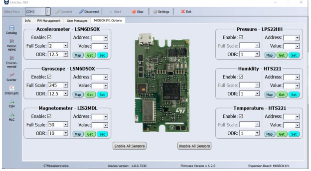

We are approaching the end of this long basic tutorial on the ST.box (the #13 number is just a case...) with the presentation of the DataLogExtended sample application. This pro-mode firmware pack implements the dialog (via USBD Virtual Com Port) with the Unicleo-GUI running on a PC connected via USB to the ST.box eval board, visualizing all the sensor data streamed from the board.

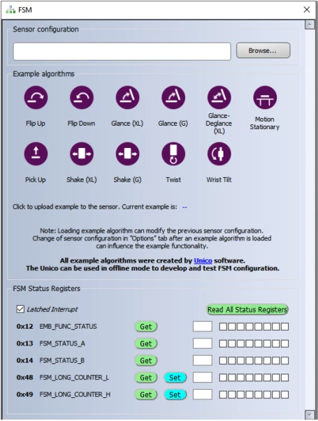

In these way all the Unicleo-GUI features described in this past post apply also to SensorTile.box platforms, allowing the user to go deep to ST.box feature. For example, it is possible to exploit all the DSOX features such as the FSM and the MLC digital features.
This summarize lot of the features and the tools described during the past months, but it's not the end... stay tuned for the next insights on a particular application of the ST.box :soon_arrow:
