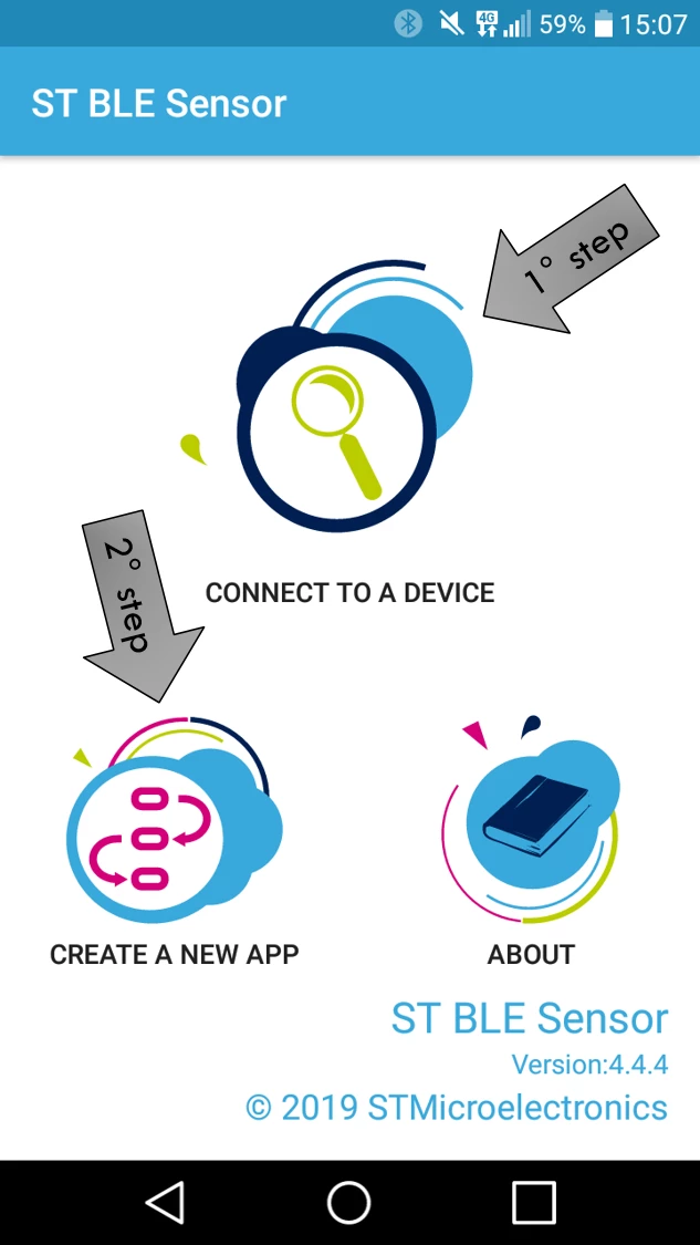

We'll start with connecting your smartphone via Bluetooth with the SensorTile.box. The tool is provided with Bluetooth® Low Energy v4.2 application processor module (SPBTLE-1S) that enables the BLE communication. Connect the tool with your charger (e.g. the PC): a red LED will start to blink. You can unplug it for IoT purposes, provided that you have charged the Li-Ion battery through USB connection via STBC02 battery charger.
Download the STBLESensor application for smartphone (available both for Android and iOS) and enable the Bluetooth connection (and the position) on your smartphone, then launch the app and connect (1st step of the picture below).
When the Bluetooth connection between smartphone and Sensortile.box is set, select "Create a new app" (2nd step). The last available official FW will be detected and downloaded on your box. This step will take at least 5 minutes...
