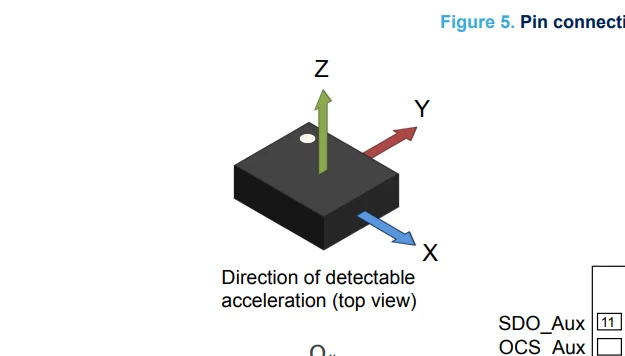

Your data sheet shows
The whit dot is important

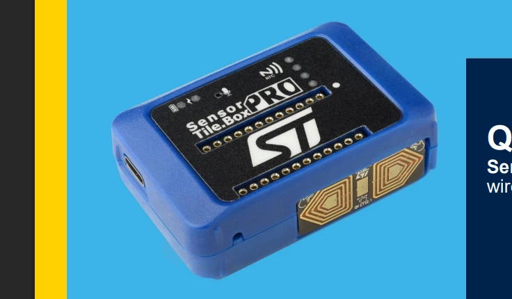

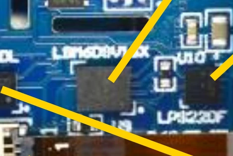

I think the white dot is in the bottom right hand corner, is the white dot on the board an indicator

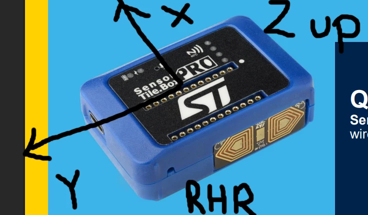

so X is parallel to the short axis of the box laying down, the Y axis is parallel to the long axis lying down and the Z axis is vertical.   Please confirm, as I have no desire to take the box apart.

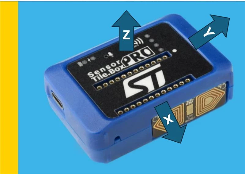

Hi ​@Smithson ,
All of the Sensortile's sensors are oriented in the same way via firmware, using axis rotation functions, regardless of how they are mounted on the board.
The orientation is as follows:

I would suggest that a normal human would assume Y parallel to the device short axis as matches most math textbooks.

I was out by 180 degrees on X and Y thanks for letting me know.

It is not reported in any document but we follow the standard ENU.

Accepted that you follow what is affectionately known as the right hand rule in Australian Physics.  The problem is the rule does not say what is the Y or N direction on a device.  I would have assumed that the device had ENU at a negative rotation of 90 degrees on your picture.
