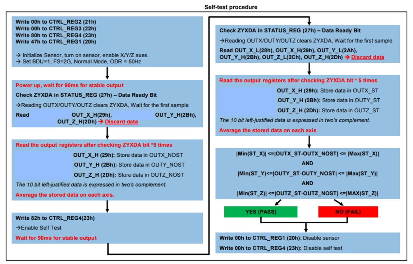

I am working on a project where I have to interface the LIS2DE12TR Accelerometer via I2C interface with TI cc2652 chip. As a start I wanted to verify the hardware functionality. In the datasheet it is mentioned of a Self-Test Mode of operation. I did not understand how the operation can be verified in the self-test. Should we just enter into self test mode and then monitor the x,y,z output values and check if they are within the specified range ? Also is there any example for this self test procedure that has been done.

    Hi @christian239955_stm1_st​, @Eleon BORLINI​,
    I figured it out.
    For the LIS2DE12, the BDU bit in CTRL_REG4 must be set to 0.
    The description of the BDU bit states:
    Block data update. Default value: 0
    (0: continuous update; 1: output registers not updated until MSB and LSB have been read)
    Since the LIS2DE12 do not have OUT_X_L, OUT_Y_L and OUT_Z_L registers, turning BDU on will prevent the output registers from being updated.

    ​Did you already set the CTRL_REG1 (20h) Xen, Yen and Zen bits, the LPen and an ODR different from the default?
    About self test procedure, you should follow this procedure
    Regards

    Visitor II
    Sep 21, 2020 1:46 PM UTC
    If anyone is following this procedure for the LIS2DE12, the BDU bit in CTRL_REG4 must be set to 0 in order for the selftest to work, otherwise you will just be reading the same output value.
    Also for the LIS2DE12, the LPen bit in CTRL_REG1 must be set to 1, as this device only supports 8-bit output.
    Apr 14, 2020 11:45 AM UTC
    Eleon
    Thank you for your support. One question to the PNG you provided for the selftest sequence.
    It states, that the 10Bit data is left aligned. The datasheet only presents OUT_X_H (29h) and no low data byte. Is there something missing in the datasheet or is the PNG not correct for LIS2DE12?

    Eleon BORLINI
    Apr 14, 2020 3:25 PM UTC
    Hi @christian239955_stm1_st​ , it's a typo ;) just need to use the OUT_X_H (29h) data in two's complement for the LIS2DE12TR. Regards
    Apr 28, 2020 1:16 PM UTC
    Dear Eleon
    I follow the procedure from your picture. I read back all configurations I do (e.g. after configuring the self-test I read 0x82 from Register 0x23).
    However, I always measure exactly the same no matter if the self-test is configured or not.
    The results are plausible when I rotate the sensor. I read -64 (* 15.6mg = 998.4mg) in whatever axis is pointing up.
    Do you have any suggestion for me?
