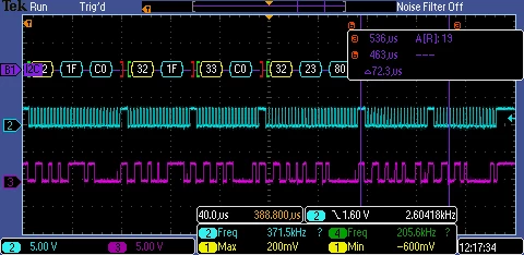

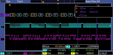

    Hi Eleon,
    Yes, I can read/write with the same routing to all the magnetometer registers, make the part work, write hard iron registers, read dual registers with no problem. I can read who am I from both the mag and acc no issues. It's just when I read the temp data registers that I'm getting back 0 even though the setup register read backs are per the datasheet. I'm attaching some scope shots showing the init(multiple images due to the long length) and an image of the actual read. I read the status register first and then read the 2 temp data registers. As a side note, I'm not able to read the acc values though, should get 0,0,1 but it appears I'm getting stuff like 0x80, 0x80 for x low and high. May be related. But I can read/write all the mag registers with the same routine with no issue.
    BMart.2

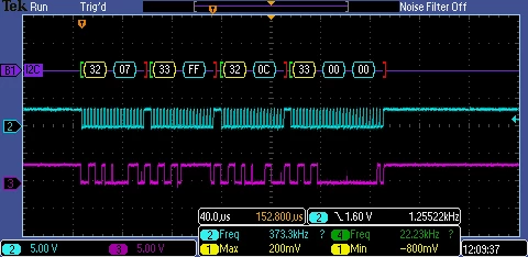

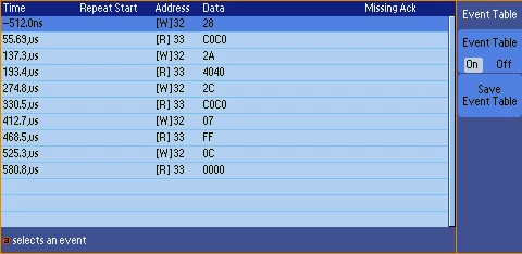

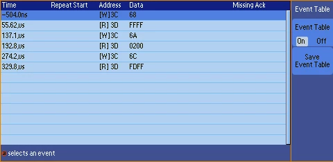

    BMart.2Author
    June 29, 2020
    Some more data to follow up on my recent answer. I'm reading the mag data registers and the acc regs and temp regs here with 100ms loop delay.

    Hi @BMart.2​ , referring to this last picture, are you maybe reading 3Ch and 3Dh (TIME_LATENCY_A and TIME_WINDOW_A) instead of OUT_TEMP_H_A (0Dh) + OUT_TEMP_L_A (0Ch) registers? Regards
