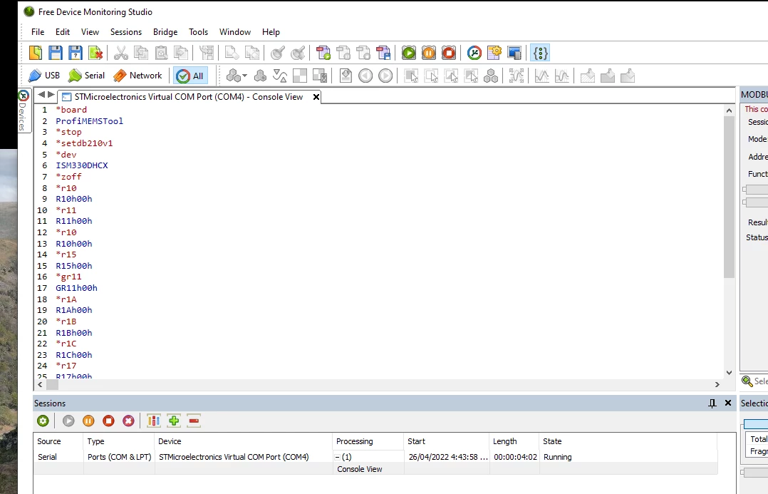

In my code, I can get the standard calls like *ver to work, and I have followed the instructions in your PDF files but even getting whoami to work is impossible for me. In UNICO LITE you have to hit two buttons to get the 68 response, *start and then *write. It is less than intuitive.
How do I get the time, temperature, tilt, gyro and accelerometer values? I am doing something wrong but three days of playing have not shown me my mistake on writing and reading from registers.

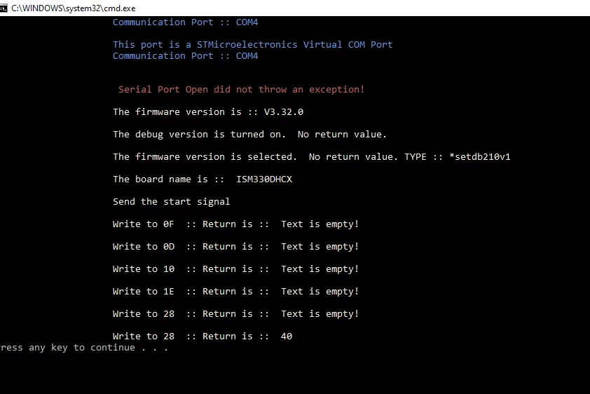

Here is the C# solution folder and a sample of the output.
sp.WriteLine(writeWA3 + "\n\r");
text = sp.ReadExisting();
if (text == "")
text = "Text is empty!";
Console.WriteLine("\n\r Write to 1E :: Return is :: " + text, Color.Linen);
Anything but ReadExisting hangs the code.
A sample of the output.
I have written a lot of code in C# for accelerometers, this is the hardest so far.
