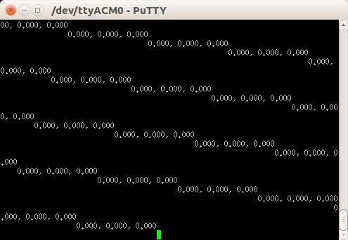

I'm trying to read data from gyroscope. I set ctrl2_g and I'm trying to read 6 bytes from register address 22h. But in result I receive only 0 values.

    2 replies
    November 28, 2018

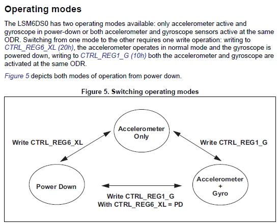

    The gyroscope in LSM6DS0 cannot work standalone you have to enable also accelerometer.
    AJab�
    AJab�Author
    December 7, 2018
    Thank you for your answer. Thanks to it, I've realized that there is difference between LSM6DSO and LSM6DS0 and I had used wrong datasheet. Now my program works properly.
