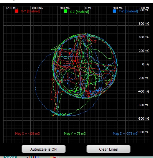

I have a compass program using an LSM9DS1 chip and the STMicro's CUBE-MEMS compass library. This is working.
I switched from the LSM9DS1 to the LISM2MDL. I am using the same program. This does not work. It appears the STMicro CUBE-MEMS library breaks (never creates good compensation values) because the LISM2MDL magnetometer values are so far out of alignment.
I captured the raw maximum & minimum magnetometer values from the LSM9DS1:
Max X: 62
Min X: -38
Max Y: 42
Min Y: -57
Max Z: 37
Min Z: -60
These are not very far from having zero average value. The offsets to make the maximums equal distant from zero:
X: -12
Y: 8
Z: 12
I adapted the program to use the LISM2MDL (I removed the STMicro HAL for the LSM9DS1 and replaced it with the STMicro HAL for the LISM2MDL. Now my raw minimum and maximum magnetometer values look like this:
Max X: -5
Min X: -44
Max Y: 21
Min Y: -16
Max Z: 30
Min Z: -9
The X values are terrible and very far from having zero average value. The others are not too bad. The offsets to make the maximums equal distant from zero:
X: 25
Y: 3
Z: -11
But when I pass these values to the STMicro CUBE-MEMS Library "MotionMC_Update()" I do not get good correction values back like I did when using the LSM8DS1.

    Are you passing the magnetometer data to the MotionMC library in correct unit which is micro tesla [uT]?
    In X-CUBE-MEMS1 is application for LSM6DSO and LIS2MDL whihc are populated on X-NUCLEO-IKS01A3, you can use it for reference,

    To further make my point, I decided to try and break my working LSM9DS1 compass program. Specifically, I am going to subtract 25 from the LSM9DS1 raw X value to simulate the bad LIS2MDL raw X value.
    This change does appear to break the STMicro CUBE-MEMS Compass Library! I am testing the code using STMicro's Unucleo-GUI's Scatter Plot and Compass features. I can no longer get the compass to work. I turn the LSM9DS1 360 degrees and the simulated compass on the screen only wiggles between ~150 to ~210 degrees. And the Scatter Plot is clearly creating 3 distinctly separate balls. Ideally, all 3 colors (x-y, x-z & y-z) would form a single ball after enough data is collected to do a proper calibration of the magnetometer.
    Do all STMicro LIS2MDL magnetometers behave this badly?

    I have re-written my LIS2MDL code to "pre calibrate" the raw data before submitting it to the STMicro's CUBE-MEMS function "MotionMC_Update()".
    I have captured the minimum and maximum values I am creating from the raw LIS2MDL magnetometer values:

    My recommendation is following:
    • Don't do any pre-calibration the MotionMC library is able to make the calibration.
    • Make the MotionMC functional before the to use MotionEC
    • You can share the data which you are passing to the algorithm. Use uT unit as I mentioned before.
    • Refer to ECompass or MagnetometerCalibration application in X-CUBE-MEMS1 package
    • You can also share part of your code so we can check it.

    I noticed there was an error in the code. I used an accelerometer HAL function to normalize the raw magnetometer value to Gauss. However, the LIS2MDL is fixed at 1.5 mG per unit of measure. So instead I now divide by 1.5 to get mG:
    		// Convert raw magnetometer value to milligauss.
    		// Sensitivity of magnetometer for LIS2MDL is 1.5mgauss/LSB, sensitivity .
    //		magnetic_field_mgauss[0] = lsm6dso_from_fs4_to_mg(data_raw_magnetic_field.i16bit[0]);
    //		magnetic_field_mgauss[1] = lsm6dso_from_fs4_to_mg(data_raw_magnetic_field.i16bit[1]);
    //		magnetic_field_mgauss[2] = lsm6dso_from_fs4_to_mg(data_raw_magnetic_field.i16bit[2]);
    		magnetic_field_mgauss[0] = (data_raw_magnetic_field.i16bit[0] / 1.5);

    ...Unfortunately, this did not fix the problem.
    Feb 12, 2020 2:46 PM UTC
    You can use function lis2mdl_from_lsb_to_mgauss to convert raw data to mgauss.
    This function multiply the value by 1.5 so I think your code is wrong.
    float_t lis2mdl_from_lsb_to_mgauss(int16_t lsb)
     return ((float_t)lsb * 1.5f);
    Rstua.1
    Rstua.1Author
    Senior
    Feb 12, 2020 3:54 PM UTC
    Ah! That Worked!
    ...can't believe I wasn't able to get here empirically (print out the values and adjust them until they are all in an expected range).
    -thanks!
