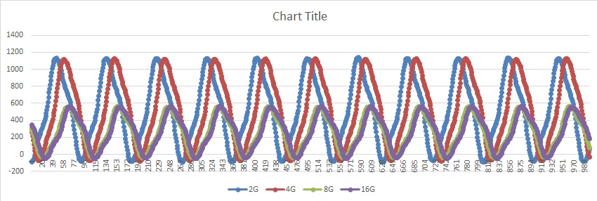

    reedomneck
    November 5, 2018
    0690X000006CJX0QAO.pngThis part I'm able to do ..
    My issue is for 8G and 16G, the raw data values are same..
    You can refer to the attached graph for more details..
    November 5, 2018
    Your raw data for 2g and 4g look also the same.
    If you measure 1g of gravity the raw value for 2g range should be around 16000.
    I think you have some mistake in your program.
