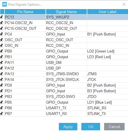

  • where is the mapping from GPIO numbers (0 through 15) to pin names on the micro (STM32WB55 in QFN68 package)? I have the board schematic which shows port names e.g. PA0, etc. but the example code refers to GPIO numbers. I can't find the mapping from GPIO numbers to pin/port names.

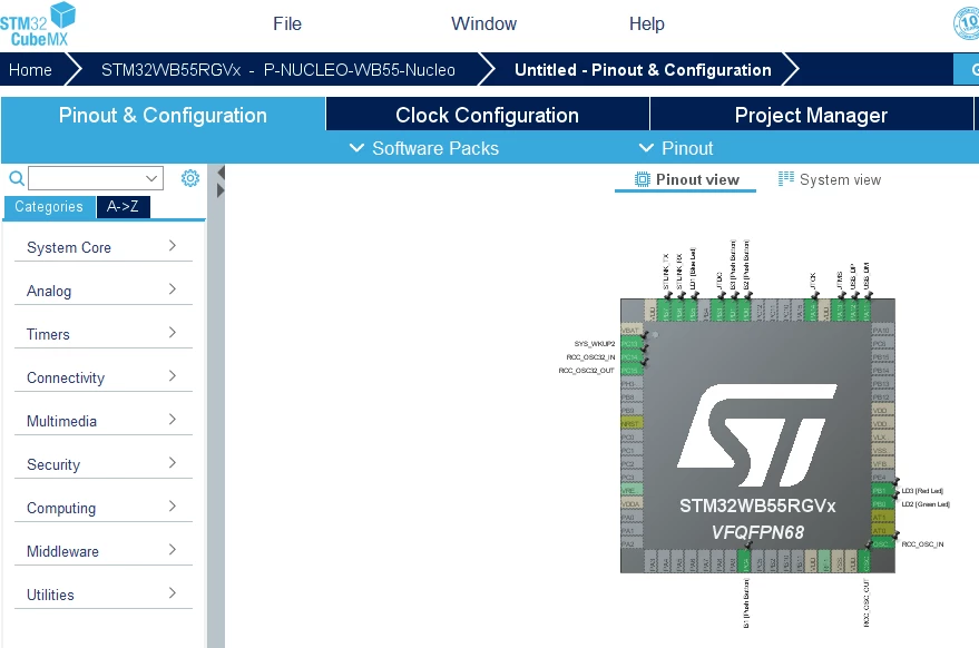

  • to match the GPIO name with the STM32WB55 pin, you can use the STM32CubeMX tool for the uC configuration, where the STM32WB55 default configuration is implemented.0693W000006FIXbQAO.png0693W000006FIXvQAO.png

I will look in MX for the pin configurations. In the image above, for example, PB0 has signal name = GPIO-Output. The code refers to GPIO0: GPIO15. I was hoping to find a reference somewhere in the code from PB0 to one of the GPIOx names, but could not find this.

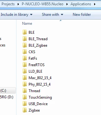

0693W000006FTnBQAW.pngHi Eleon,
My STM32Cube_FW_WB_V1.9.0 installation doesn't include the MOTENV1 application folder. See the image above.
My installation of the MOTENV1 function pack doesn't have a subfolder for the P-NUCLEO-WB55.
Do I need to install something else?
I will take a look at the read_data_single C file.

Eleon BORLINI
Eleon BORLINIBest answer
Dec 21, 2020 9:58 AM UTC
Hi Jim @JTomp.1​ ,
sorry, it is the FP-SNS-MOTENVWB1 function pack (not the FP-SENS-MOTENV1), which is dedicated to the P-NUCLEO-WB55 + X-NUCLEO-IKS01A3.
