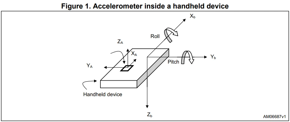

In the figure shown below,
Xb, Yb and Zb are device body axes with a forward-right-down configuration.
XA, YA and ZA are the accelerometer sensing axes.

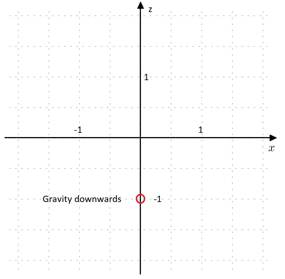

When sensor is placed still on the table, i expected the value from accelerometer z axis is -1g because there is a downward acceleration due to gravity.

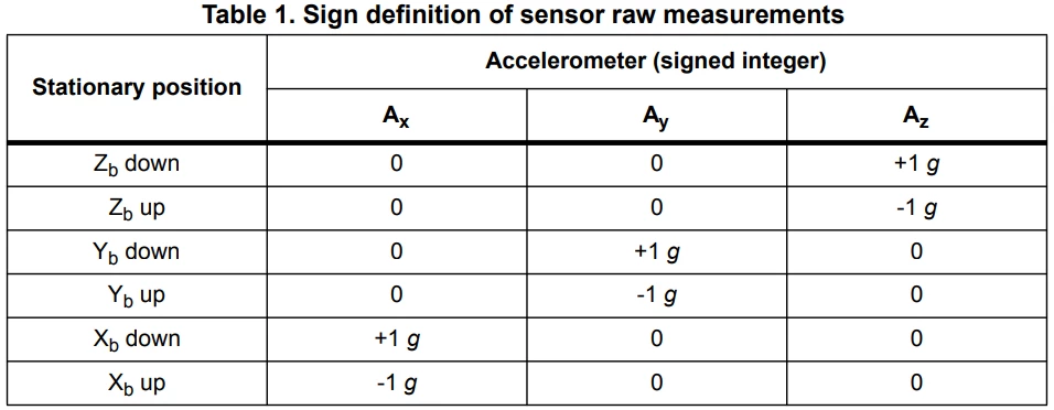

But the application notes mentions that Az would output +1g when Zb pointing down .
Why the signed is reversed?
