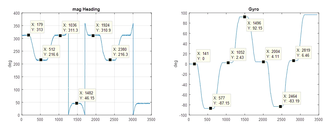

    here is response from my colleague who is expert on sensor fusion:
    At the start of the MotionFX, heading is initialized with zero degree and will initial the heading value using magnetometer value only when there is a motion.
    This is done to make sure magnetometer is calibrated and it can be determined only when there is some rotation. Therefore, the customer is seeing 0 at the beginning but after rotation, it converges to 217 deg.
    When I compare the rotation from mag and gyro : Here is the value I am getting
    Heading from Magnetometer : [-97 (313->216), 95, 95, -95, -95]
    Heading from Gyro integration : [-87,90, 90, -88, -88]
    The differences in both sensors show some calibration issue with magnetometer but it is acceptable. As MotionFX get more data, it tends to handle the error better due to better observation of error.
