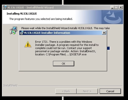

Hi friends,
I have trying to install the VL53L1X GUI software in my desktop station but I cann´t do it because it shows me the next message:

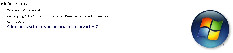

My OS is (windows 7 - 64 bits):
I have also tried to install the program in another computers (Windows 10 - 64 bits) but the problem remains.

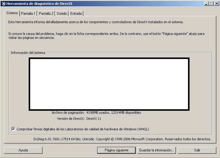

    Hi Clive,
    Sure. If I run the program DxDiag it shows this form:
    I?ve got the version 11.
    Are there any special requeriments for the VL53L1X GUI?
    I have installed other ST?s GUI for other sensors but I have never seen this failure.
    Thanks for your response.
    Best regards.
    Jesus

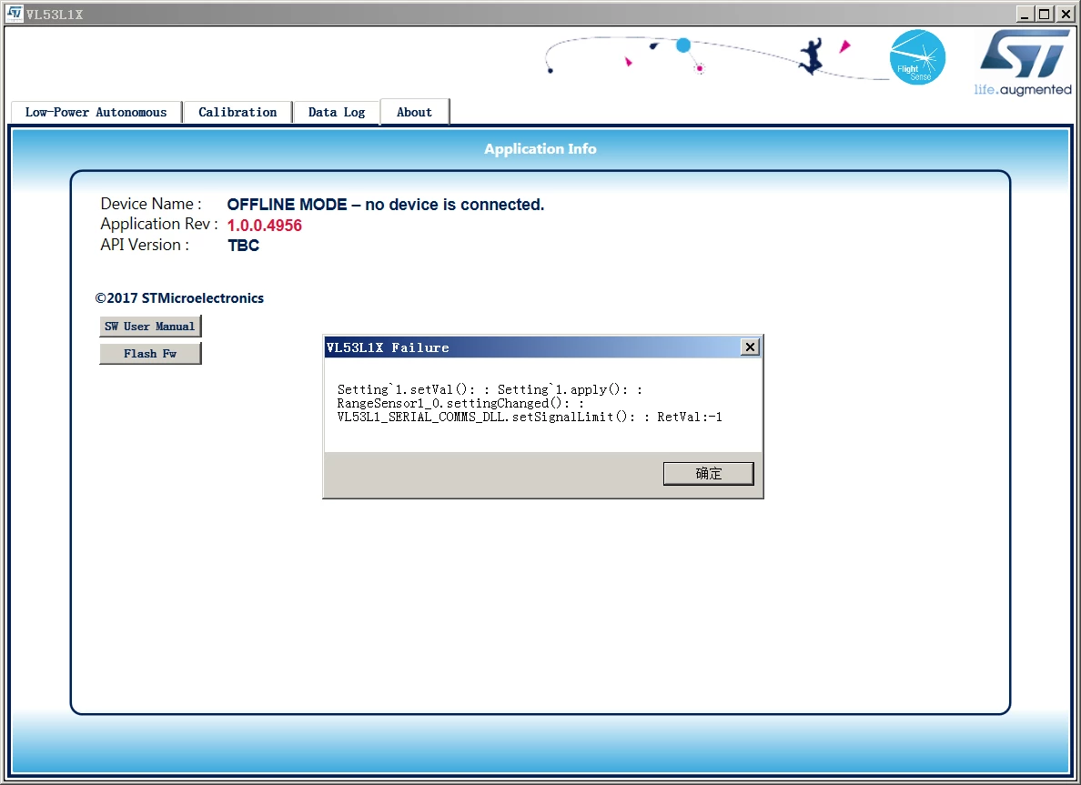

    I had the same problem , it can be solved by changing the installation path from ''c'' to another one, for example desk ''d''.
    but i have a new problem:
    When i connected the F401RE+53L1A1 evaluation board to PC and run VL53L1X_GUI, i got the following message:
    so i could not do the Cal Ref Spads calibration and range measurement as well.
    Any one know what to do next?
    John E KVAM
    Jun 7, 2018 2:15 PM UTC
    Posted on June 07, 2018 at 16:15
    This is a Microsoft issue.
    Here below the answer from Microsoft, but please first ensure that you are administrator:
    would suggest you to try the methods below and check if it helps:
    Method 1: Restart Windows Installer service
    Restart the windows Installer service by following the steps below and check if it help:
    1. Press Windows key + R to open the run command.
    2. Type services.msc and press enter.
    3. Right click on 'windows installer' and stop the service.
    4. Right click again and start the service and try to install the program.
    Method 2: Run the fix it tool
    Download and run the fix it tool from the link below and check.
    https://support.microsoft.com/en-us/mats/program_install_and_uninstall?ppud=4&wa=wsignin1.0
    (Applies to Windows 10)
    Method 3: Install in compatibility mode
    In order to identify if this is an incompatibility related issue, I would suggest you to try the steps below to install the program in compatibility mode by following the steps below and check if it helps.
    1. Right-click on the setup file of the program and select 'Properties'.
    2. Select 'Compatibility' Tab.
    3. Place a check mark next to 'Run this program in Compatibility mode' and select Windows 8  from the drop  down list.
    4. Let the program install and then check the functionality
