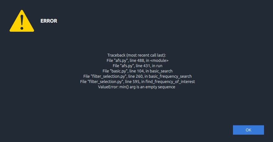

First, I collected 4 samples of a basic jab motion and labeled the data "strike" and "retract" for each. Everything worked up to the point where I generated the decision tree and got a confidence value of 0%. Then, I attempted to simplify the data and only use one sample of one movement (just the strike component). At this point, I began to see the error below when running the AFS tool.

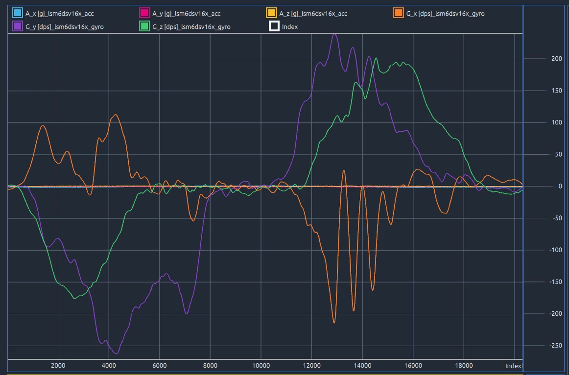

I collected new samples, this time a simpler and slower bicep curl movement:
Even with the new data, I continue seeing the same error when running the AFS tool. Is this a bug, or something I'm doing wrong? My goal is to eventually detect baseball swings and use the interrupt from the MLC as a trigger for storing high-frequency IMU data, but at the moment I'm not able to successfully produce a configuration for the MLC using simple movements.

I tried again by setting explicit labels for the "up" and "down" motion of a bicep curl. When I add two samples of each, I get the error below:

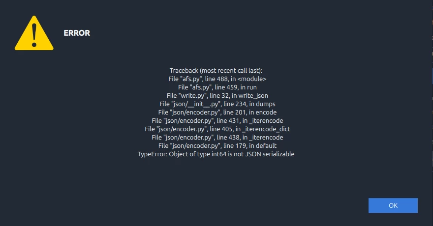

When I only add one sample of each, I successfully run the AFS, generate the ARFF file, and get an error on the decision tree generation step.
I wish more context would be provided when these errors are flagged. Script error tracebacks don't provide sufficient information about what exactly I'm doing to wrong in order to troubleshoot this independently. I also haven't found any online forum posts or documentation about these errors, so I'm assuming it's some sort of issue specifically related to my setup and/or data.

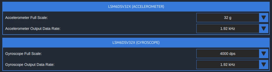

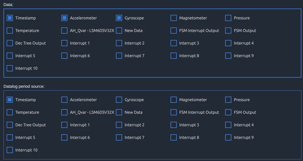

1. Connect STbox.Pro to MEMS Studio, set accelerometer and gyroscope range.
2. Only enable timestamp, accelerometer, and gyroscope in the Save to File tab for datalogging.

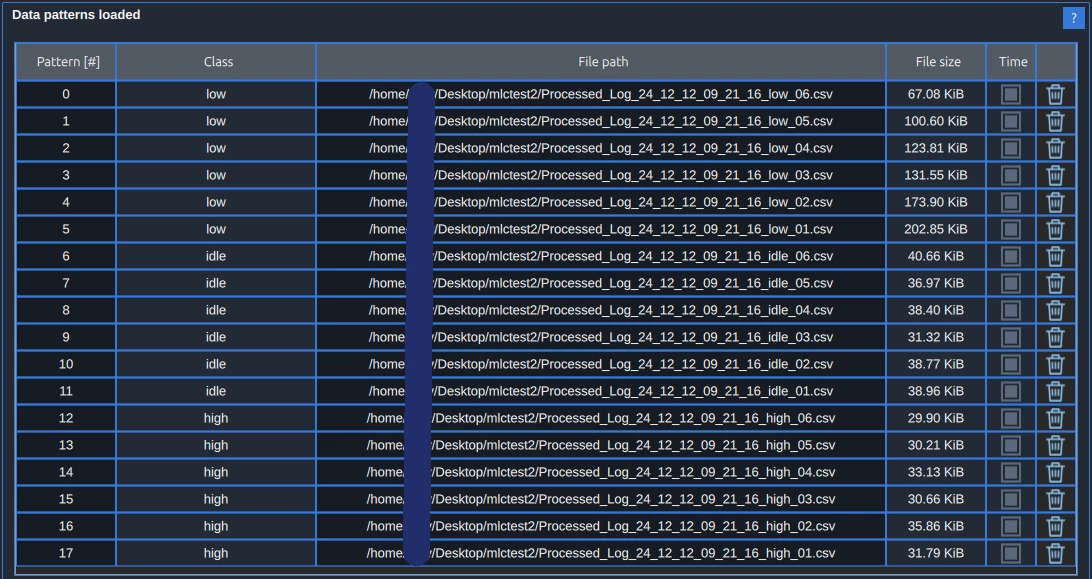

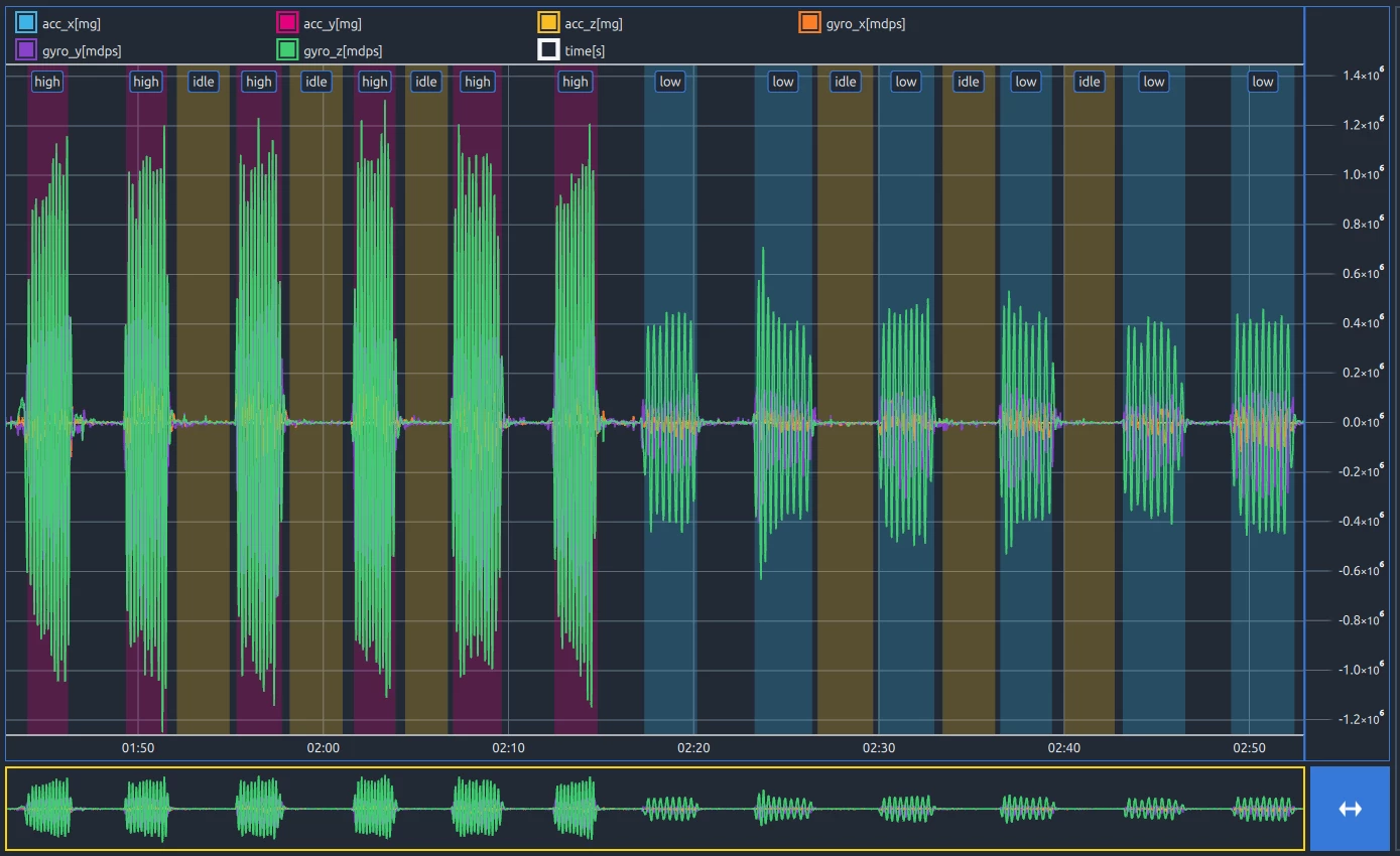

3. Label data using the Data Analysis tool.

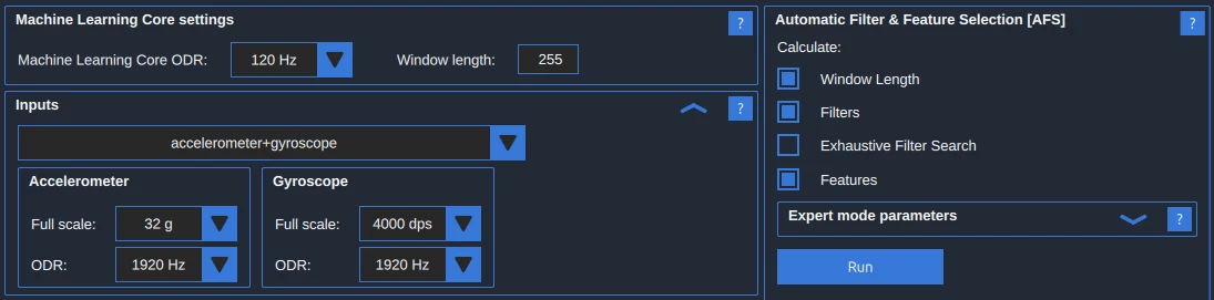

5. Attempt to run the AFS tool.

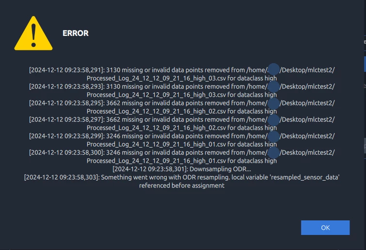

I tried a variety of configurations on the AFS window between ML ODR, window length, selecting just accelerometer or just gyroscope, disabling certain outputs, removing samples, etc. but I always get one of these errors.
Miroslav BATEKBest answer
Dec 17, 2024 4:46 PM UTC
Hello @rbmarcus,
I have analyzed your project. Unfortunately there is an issue in MEMS Studio in saving the labeled data in Data Analysis tool. This caused data corruption and the logs cannot be process by the AFS tool.
A workaround could be split the unprocessed log in different tool or acquire the data for each class separately and don't use the Data Analysis to split the data.
We are planning to release new version of MEMS Studio with the bug fix this week.
I'm sorry for inconvenience.

Mar 12, 2025 1:40 PM UTC
Thank you. I was able to replicate the issue and we are analyzing it.
It seems the error is triggered if you want to calculate Windows length + Filters + Features, but in case of separate Windows length and Filters + Features calculation the error doesn't appear. Maybe you can use this two step approach as temporary workaround.
