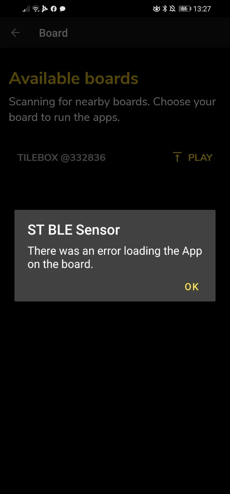

Problems to pair SensorTile.box to ST BLESensor Application. Basically it scans for nearby boards and then gives an error loading the App. What can I do?

    HI @ATrif.1​ ,
    which application are you trying to upload on your SensorTile.box? An already-built one (Mode1) or a custom one (Mode2)?
    I see that the, so you correctly paired the devices, right (using the 123456 code)?
    -Eleon

    Hi Eleon,
    Basically I follow this pathway : Create an application - Vibration Monitor - Vibration Monitor compare.
    And the first time SensorTile.box was connected to the mobile App i used 123456 code to pair it.

    Hi @ATrif.1​ ,
    It might be related to the Vibration Monitor compare only. Are you facing the issue also while uploading other predefined apps?
    The "Vibration Monitor compare" needs a csv file on the SD card, which is the reference for the vibration monitor comparison. You can create it in a first step, writing an acceleration pattern on the SD card, and then try again uploading the Vibration Monitor compare app.
    -Eleon

    Hi Eleon,
    Well, I also tried to upload other predefined apps, but unfortunately this problem persists.
