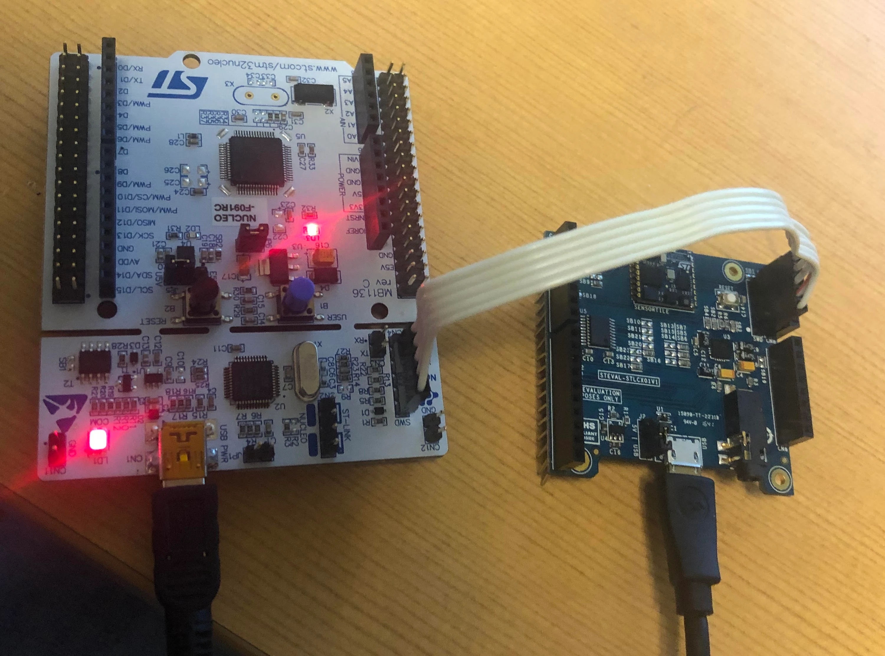

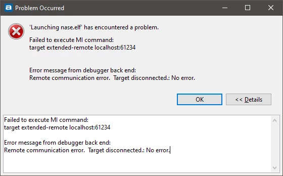

I am having a hard time getting started with the SensorTile and need some help. I am using CubeMx (v5.3.0) for the STM32L476JGYx selection, and observe the following result when I try to debug -
Here is the error message:
Here is the test setup:
Thoughts? What is causing this, how to correct?

I have an ST-Link/v2 and J-Link EDU on-hand if useful. I have a new SensorTile & breakout coming soon, our team has need to get this running please let me know your thoughts when available.

waclawek.jan
October 16, 2019

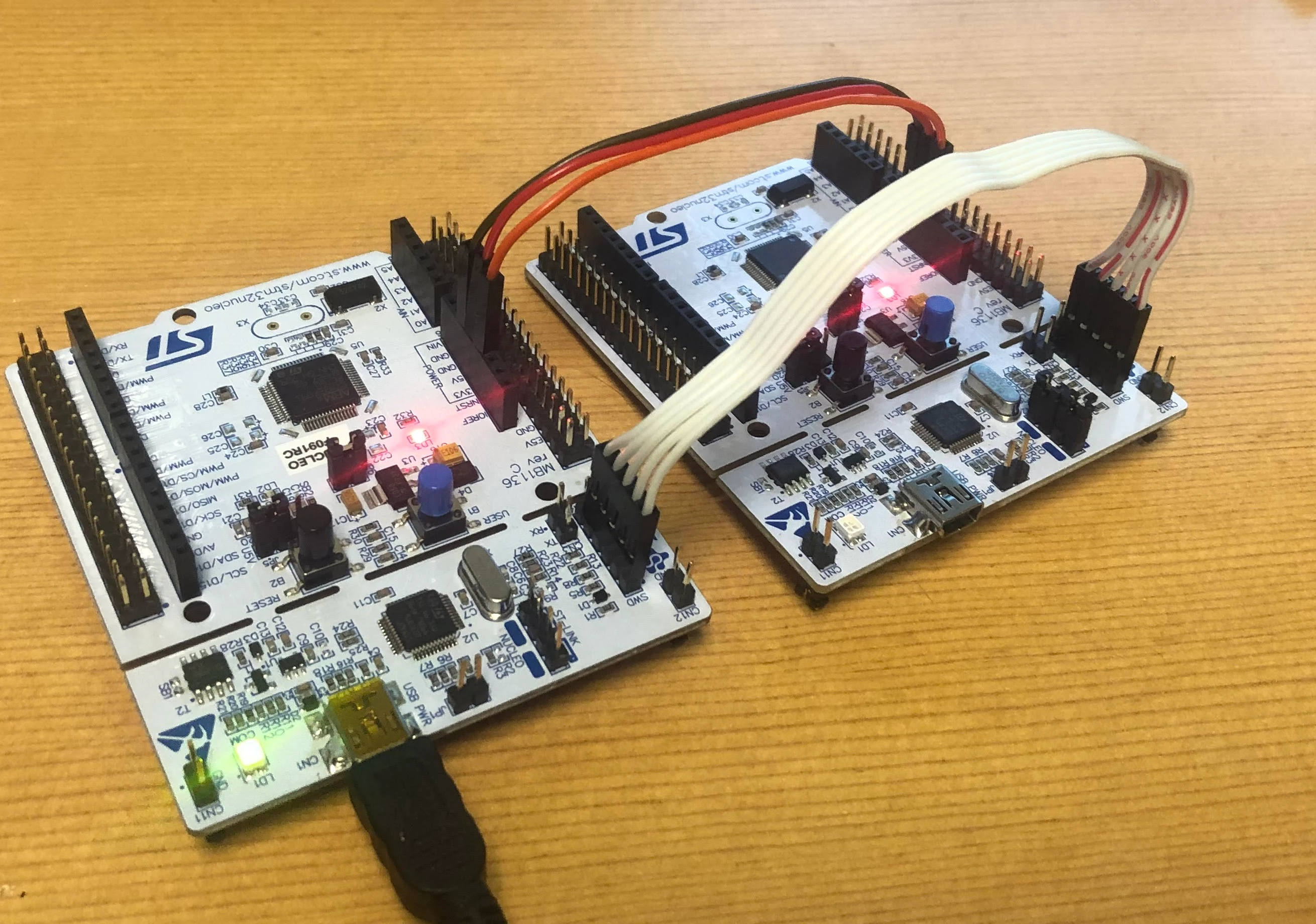

Can you connect using STLink-Utility?
Cable orientation is OK?
Can you connect to some different STM32 target with this STLink/Nucleo?

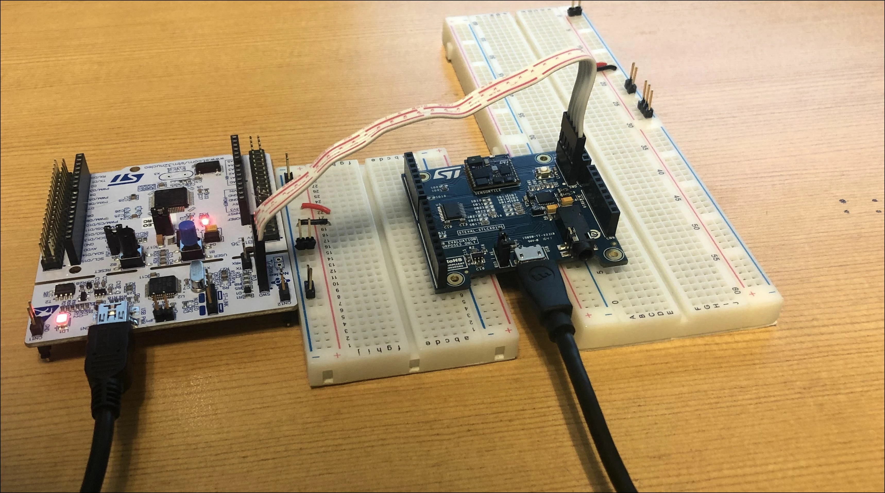

My gosh, now it all works - THANK YOU Jan!!
I have spent a lot of money, time and efforts into this, very grateful for your help resolving this. Here are my working configurations for future reference -
