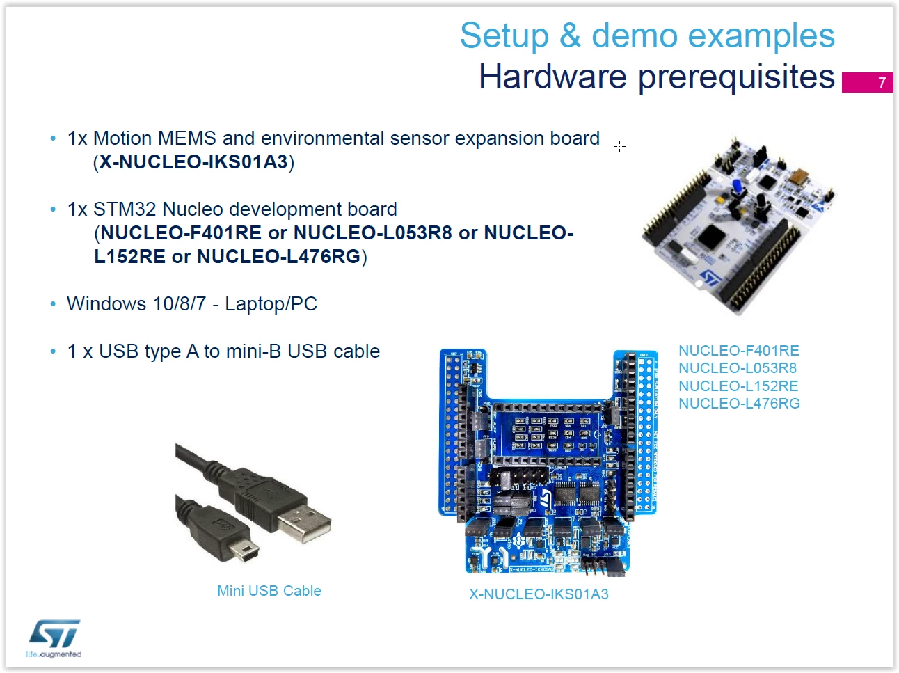

I have to boards L476RG and 303RE and of course IKS01A3 .
After installing Unicleo , I can't connect to that IKS (It's not even showing port )  . I'm changing boards but still It can't see it .
On some tutorials some lady was coping some files to the folder which is being created after connecting the board to USB . But my board is not even existing in examples .
Simple question : How I can connect IKS using my boards (476RG or 303RE ) vand see the values from sensors ?
Best Regards ,
Samu

Unfortunately, this combination of boards X-NUCLEO-IKS01A3 + NUCLEO-L476RG (and NUCLEO-F303RE) is no more supported in the X-CUBE-MEMS1 package. You could manually port DatalogExtended firmware from X-CUBE-MEMS1 to your board.
February 16, 2024
Thank you for your reply.
I have found it in x-Nucleo-iks01a3_quick_start_guide
However, I have checked the latest supported boards in MEMS1 library folders  and they are :
NUCLEO-F401RE
NUCLEO-L073RZ
NUCLEO-L152RE
NUCLEO-U575ZI-Q
Can you confirm this?
Best Regards,
Pepe

Hi @pepebisup12 ,
Yes, the boards you are loooking are not supported by X-CUBE-MEMS1. NUCLEO-L476RG used to be supported, that is why it is mentioned in the getting started document for X-NUCLEO-IKS01A3 but it is not supported anymore.
