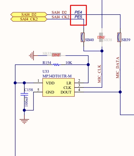

Problem with enabling onboard MEMS microphone using SAI interface on STM32H735IG discovery board

Hi @PZare.1​ Pawel,
I checked internally with our experts, and they suggest to check the settings of the pins: the mic is connected to PE4/PE5, while you are configuring the PD6/PE5.
0693W00000AMGE3QAP.pngBefore checking in more details your configuration, please see what happens changing the two pins, and let me know.
-Eleon

thanks for checking! I did the changes as you suggest:
 GPIO_InitStruct.Pin = GPIO_PIN_5;
 GPIO_InitStruct.Alternate = GPIO_AF10_SAI4;
 HAL_GPIO_Init(GPIOE, &GPIO_InitStruct);
 GPIO_InitStruct.Pin = GPIO_PIN_4; // changed for pin 4
 GPIO_InitStruct.Alternate = GPIO_AF1_SAI4; // not changed AF1 alternate pin
 HAL_GPIO_Init(GPIOE, &GPIO_InitStruct); // changed for port E
Only change that I noticed is that right now my buffer is filled with "0x00" values instead of "0xFF" values.
Pawel
Edit:
Changed alternate pin to GPIO_AF10_SAI4 as well, same results.

Hi @PZare.1​ ,
do you have the possibility to check the PDM data (and then the PCM stream) with a scope?
-Eleon
PZare.1
PZare.1Author
May 4, 2021
Hello Eleon,
I checked signal on PE5 pin (SB40 on your board schematic) - clock is clocking with 133kHz frequency, on pin PE4 (SB39) there is always 0 V.
Pawel
