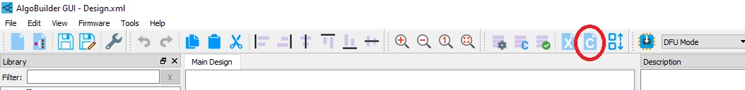

    When I click on the button below,

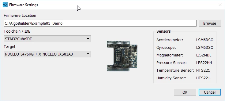

    0693W00000APANtQAP.pngThis screen opens:

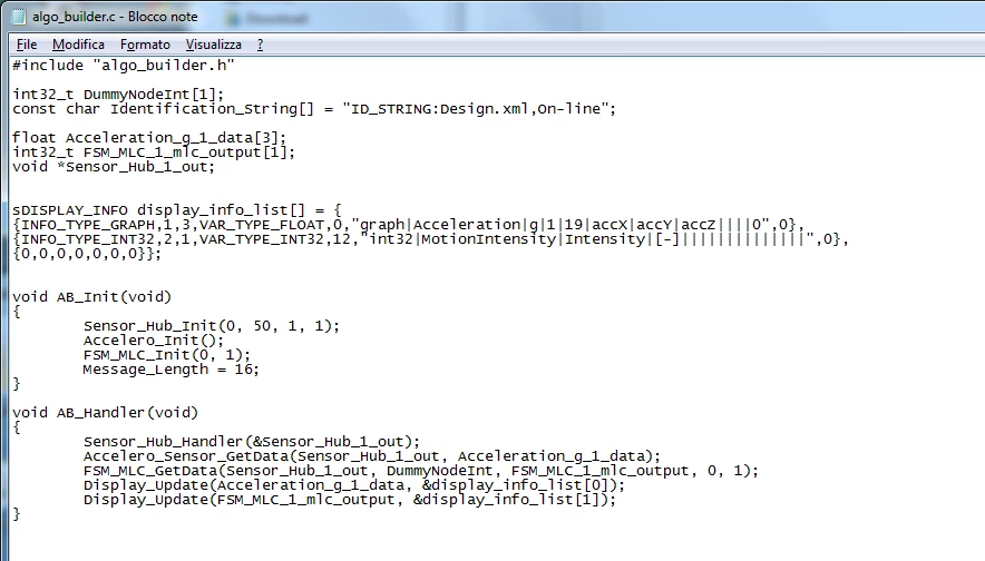

    0693W00000APAONQA5.pngthis windows open...
    Is this all the code I need in my microprocessor to have the operazion done? (obviously with the driver...)
    Where is the code generated?
    Thanks,
    louda.marian
    May 21, 2021
    Hi Cristian,
    algo_builder.c file is the part of source code which changes according to algorithm design.
    The rest of source code is placed inside directory specified in "Firmware Location" (see the picture).
    Inside sub directory "Projects" are placed configuration files for all supported toolchains.
    You can open the project in your preferred development IDE to see whole structure of the project.
    Best Regards,
    Marian
