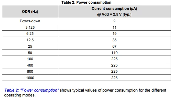

Hi all
Can I have a table of power consumption for LIS3DSH in different sampling rate?
Kind Regards
Reza
    2 replies
    Eleon BORLINI
    July 24, 2019
    ​Hi Reza, you can find the current consumption table in p.10 of the LIS3DSH app note AN3393
    Regards
    MNaee
    MNaeeAuthor
    August 1, 2019
    Thank you Dear Eleon
    It seems that power consumption of LIS3DSH is considerably higher that LIS3DH :)
