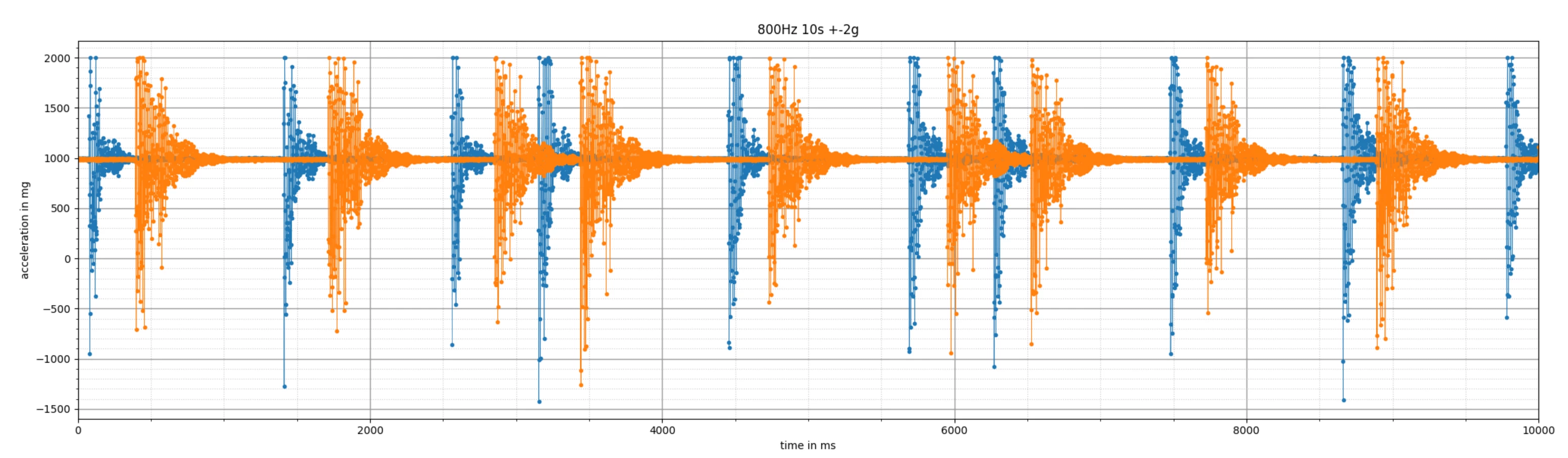

I am interested in measuring the acceleration with two LIS2DS12 sensors at the same time. Therefore, I start the measurement (nearly at the same time) with a sampling frequency of 800Hz for 10 seconds with +-2g full scale range for both sensors. The test case is the following. Both sensors lie on the table and I apply slight shocks at the table.
My expected result is seeing the vibrations at the sensor data at the same time at both sensors. Maybe there is an offset between the two sensors due to an inaccuracy at starting both at the same time. But this offset should remain constant over the 10 seconds measurement time.

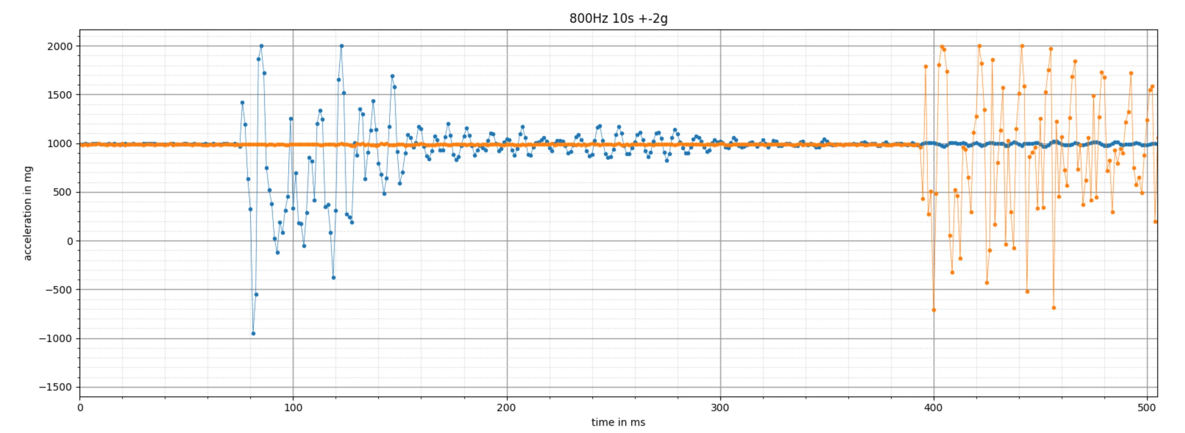

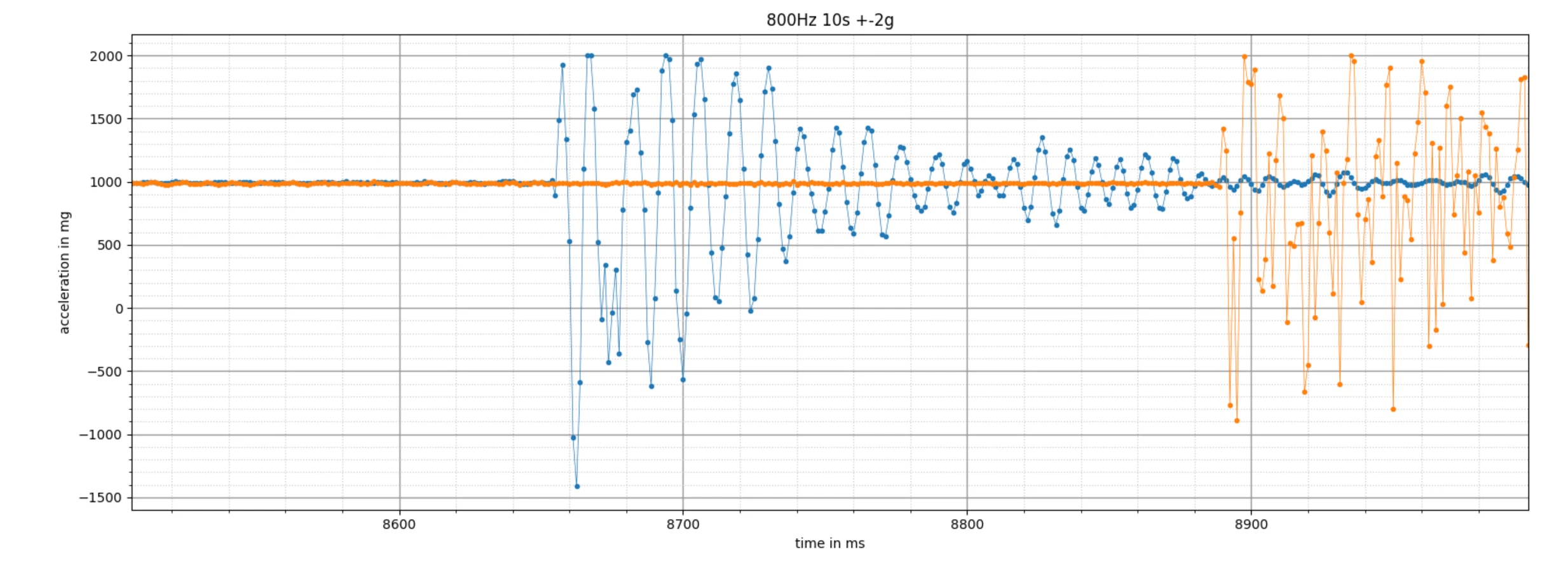

As you can see in the attached picture (measurement.png), I succecfully measured the vibrations with both sensors. There is also the offset due to the inaccuracy in starting both sensors at the same time. But if we take a closer look the offset will not remain constant. It shifts. Picture first_shock.png as the name says, shows the first shock of the measurement. The last measurement point of the first sensor before the shock occurs is at about 74ms and the same for the second sensor is at about 393ms. So the offset between the two sensors for the first shock is 319ms. If we take a look at the last_shock.png we will see an offset of 233ms between the to sensors.

I checked with some colleague and the discrepancies in actual ODR value is common (it varies for a lot of physical reasons), both for average and punctual values.
checking the values, there is a deviation of 1.2% from the nominal 800Hz.
this value is not common (usually it is lower) but it is not possible to be perfectly precise.
If, for your application, you need an ODR more precise that this, you can follow 2 different paths:
  • characterizing the ODR how you did, you found the difference in average ODR, so you can compensate this difference by discarding some sample in the faster sensor
  • you can also try to run with a higher ODR and see if the situation gets better. this way you can at least have more samples and be able to decide which ones to use

from the picture where I see all the data I cannot get how much ms are there between the middle shocks.
maybe you can also get a longer acquisition to see if it grows even larger.

You are right, the temporization is provided by software. To be exact I wait until each sensor has measured 8000 samples (800Hz * 10s). During the measurement I count the counter ticks with the function RTCDRV_GetWallClockTicks64() and convert it into milliseconds. I noticed that one sensor takes about 10019ms and the other about 10119ms for the whole measurement, so there is also a difference of 100ms. This is another reason why I think there could be discrepancies in the ODRs.
Regarding to the discrepancy in the middle of the picture I can supply you with all the values from the first to the last shock:
319ms; 306ms; 294ms; 286ms; 278ms; 265ms; 258ms; 248ms; 233ms
I took another measurment (with the same settings of course) and I can also provide the time differences from this :
515ms; 504ms; 533ms; 564ms; 425ms; 378ms; 400ms; 371ms; 381ms; 371ms; 355ms
By now I can not see a pattern in the change of the discrepancies. It seems random for me.
