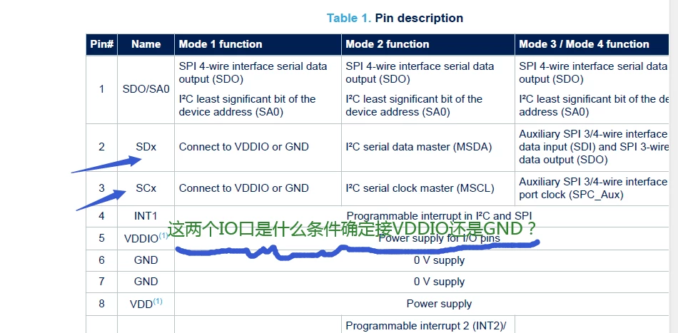

anne
July 11, 2022
Dear andrew
0693W00000QKibkQAD.pngPLS help us which conditon this item connect with VDDIO or GND?by the way,my e-mail adress is purchase@zeuselectronic.com,we need more help for this item,tks.
