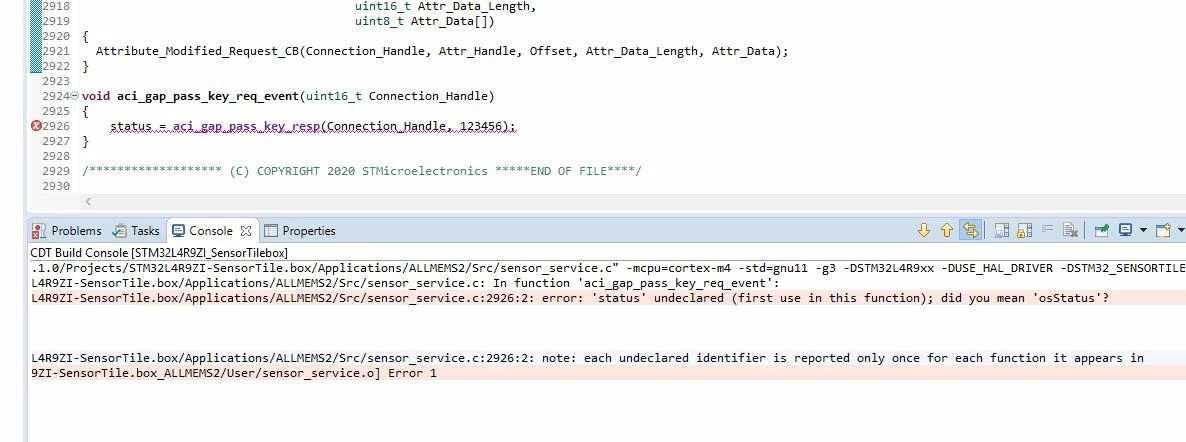

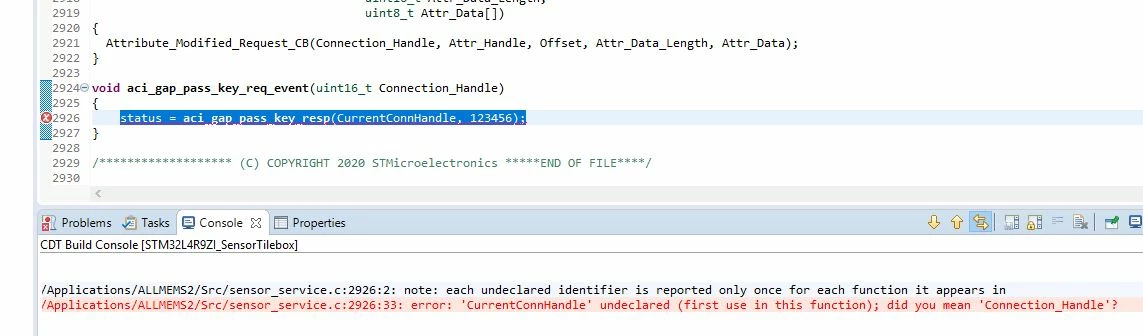

    david binkowski
    Oct 9, 2020 12:35 PM UTC
    Hi Niccolo,
    I encountered couple of error
    and second when i try to change CurrentConnHandle to Connection_Handle
    I suppose that i need to declare some variables. I precise that i use the same FW version like you ALLMEMS2 V210
    Thanks for you help
    Regards
    niccolò
    Oct 9, 2020 1:04 PM UTC
    Hi @david binkowski​ ,
    status is a variable that is there for debugging purposes, you can either
    • get rid of it, so that the function becomes:
    void aci_gap_pass_key_req_event(uint16_t Connection_Handle)
     aci_gap_pass_key_resp(Connection_Handle, 123456);
    • or declare status as a uint8_t the line before, so it becomes:
     uint8_t status;
     status = aci_gap_pass_key_resp(Connection_Handle, 123456);
    in the latter option, you have a variable that can be checked during debug, but in the end it should not be a problem for you.
    Let me now if this solves your problem.
