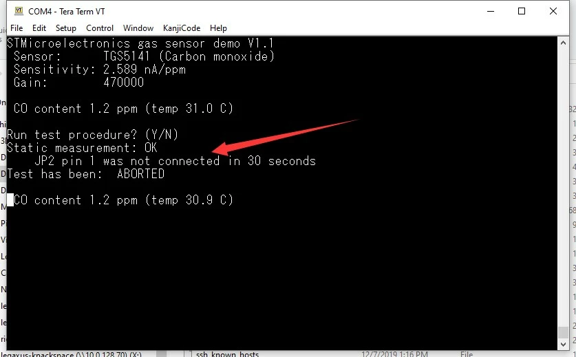

jason239955_st
April 16, 2021
Hi Eleon,
I am using this evaluation board with the Nucleo-L053R8 to do the evaluation and getting the result of the CO sensor.
After testing a few rounds, I noticed there was a setting "T" on the for test the sensor using the NUCLEO together with the sensor expansion board.
I keep getting error while try to run the test procedure, screenshot attached
Datasheet not mention the test procedure, I am confused with the error message "JP2 pin 1 was not connected" what does that mean? and what should I do?
JP2 on the sensor expansion board is GAIN settings, I tried shorted pin 1-2, same error, and tried shorted 2-3 also same error. Appreciate if you could help on this issue.

Hi @jason239955_st​ ,
Are you using the board with the default firmware uploaded?
As another interface channel, as shown in the UM2247 user manual, p.11, you could use also Unicleo-GUI to interface the board. It contains a Custom Fields window which fully supports the P-NUCLEO-IKA02A1 expansion board to show the measured values in a graph. The source code for NUCLEO-L053R8, NUCLEO-F401RE and NUCLEO-L476RG boards is available in the X-CUBE-IKA02A1 software package as DataLogCustomLite sample.
Did you already tried this solution?
