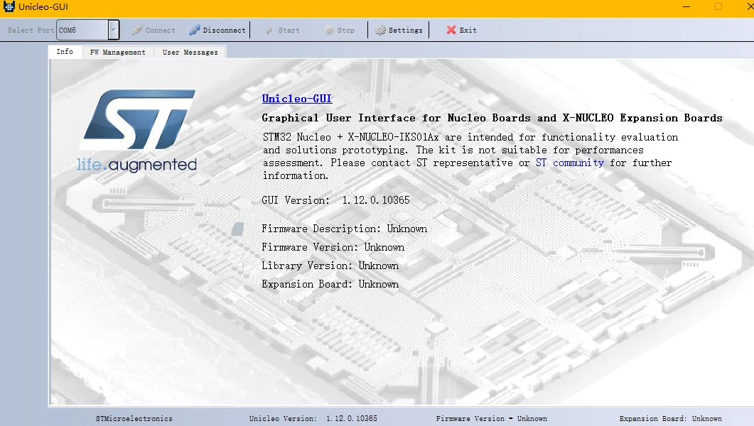

nucleo-gui can connecet uart port,but can not statrt
nucleo-gui can connecet uart port,but can not start, like follows

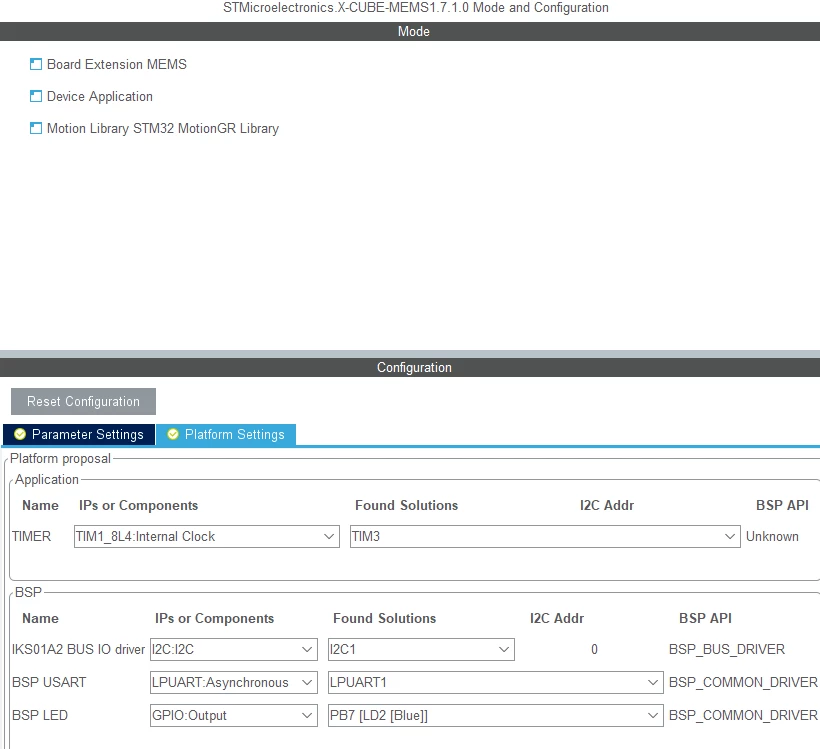

1.nucleo borad: nucleo-l4r5zi , mems borad: iks01a2
2. using X-CUBE-MEMS1 7.10 gesturerecognition appliction
anyone know what is problem? thank you?​

    the problem I see is wrong settings of the Baud Rate for the communication port LPUART1. It should be 921600.
    Unfortunately, I don't have this NUCLEO-L4R5ZI right now so I can't check it on real hardware. So please try to change the Baud Rate.

    would you please attach your ioc file from CubeMX so we can check it?
    Which IDE you use? Was the compilation without any error or warning?

    Hello, I think I've seen the video you recorded vd_2018_Unicleo_SW_tool. Please see the attachment for IOC file。 IDE uses mdk-arm5.26.2.0.There are no errors and warnings。Please see the attachment for the whole project。thank you very much�?

    It is ok now. Thank you very much. I love you so much,谢谢�?
