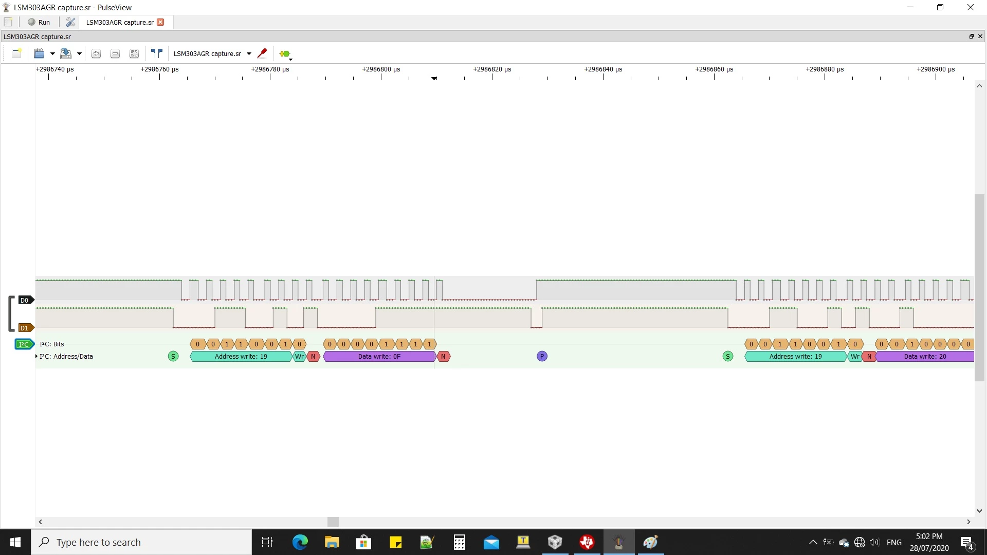

Eleon BORLINI
Jul 30, 2020 11:56 AM UTC
Hi @MRobr​ , quite strange... are you sure the only difference between the old an d the new board is the LSM303AGR? There have been no change in the I2C slave address of LSM303AGR:
 /** I2C Device Address 8 bit format**/
#define LSM303AGR_I2C_ADD_XL 0x33U
#define LSM303AGR_I2C_ADD_MG 0x3DU
/** Device Identification (Who am I) **/
#define LSM303AGR_ID_XL 0x33U
#define LSM303AGR_ID_MG 0x40U
Did you check the digital pattern with an oscilloscope? It may be however another kind of issue: are you receiving an acknowledge on the SDA line? Which pull-up resistors are you using? The Vdd / VddIO is always the same? The application processor is the same?

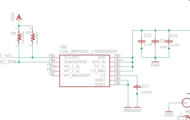

Eleon BORLINI
Aug 21, 2020 10:29 AM UTC
Hi Markel, sorry for the late answer to your question... No, it is ok to use that kind of package for the capacitors. Are you still having issues with the I2C communication?

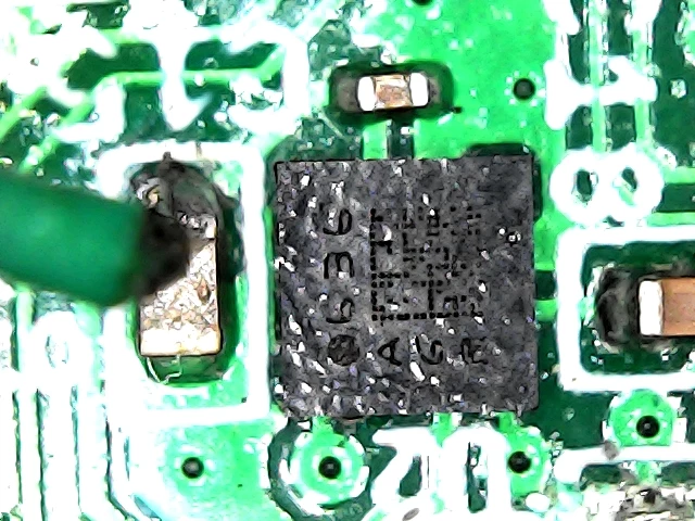

Jul 30, 2020 12:12 PM UTC
Hi Eleon,
Here is the I2C Logic Analyzer to read the Device ID, From this we just write but no reply from the LSM303AGR. I am using TI CC2640R2F to communicate with LSM303AGR.
Here is the USB Microscope picture of the LSM303AGR. From the marking I am not entirely sure if it is LSM303AGR.
Here is the LSM303AGR circuitry which is according to the datasheet. The pull up resistors value is 5.1 KOhm
Using the I2C lines of this board, I communicated with I2C TMP007 of another board without problems, meaning there is no problem with the I2C lines. My troubleshooting investigation is pointing to that there is really a problem with the LSM303AGR or the I2C Slave Address is different.

Tesla DeLorean
Guru
Jul 30, 2020 12:25 PM UTC
With I2C you should be able to probe the slave address space to find any responding devices.
You could also try bit-banging the I2C to see if that works.
Check part orientation, soldering, solder mask, cleaning.
If you have X-RAY equipment you could use that.
Check continuities on an unpopulated PCB, double check design expectations, and nets
MRobr
MRobrAuthor
Aug 1, 2020 5:52 AM UTC
There is only I2C device connected to the MCU, which is the I2C LSM303AGR. I already did most of your suggestions before except the xray, which we do not have access.
