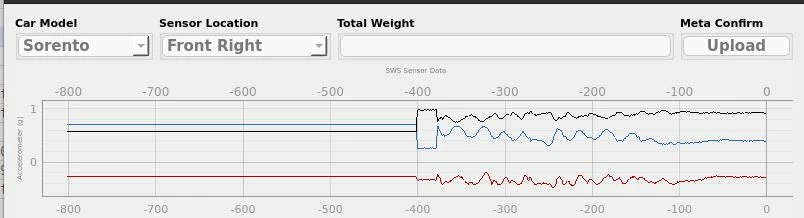

Our board is streaming accelerometer, gyrometer(lsm6dsox) and magnetometer(lis3mdl).
It sleep and wake-up depends on accelerometer threshold.
Usually data is streamed out well.
But time to time, data is not updated from magetometer after wake up.
In below picture, from -800 to -400, same value is read although sensor is shaken.
After power reset at -400, sensor data is read well again.
0693W00000Ba4AkQAJ.jpgSince WHO_AM_I is checked every time after-wake up, I think SPI or sensor is okay.
Below is register setting during initialization.

Could you help me to find out what is problem?

    Hi @Community member​ ,
    I don't really know where the problem is, but can you check what is the difference between the start-up of the sensor after the wakeup interrupt and after the reset?
    I think that you can find there the answer to the problem.
