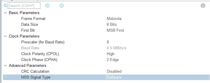

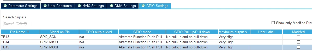

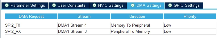

I have set up the STM32's SPI with STM32CubeIDE, with settings shown below:
0693W000005CumUQAS.png0693W000005CumeQAC.png0693W000005CumtQAC.pngI try to read the register WHO_AM_I which returns an address using the following functions:

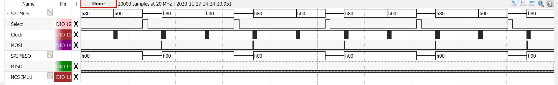

When i look at the signals with a logic analyzer i see the following:
Nice and clean communication from the STM32, writing two bytes, first being address (Who am i 0x00 + readbit) and the second being empty, as it expects to receive data.
All lines are checked with multimeter, and are connected properly, no pullups or anything on the SPI lines. The device is receiving 2.5V VDDIO and 3.3V VDD

    Are you sure you run the ICM-20948 at VDDIO=2.5V?
    The data sheet of the ICM-20948 only allows a VDDIO in the range of 1.71V...1.95V. But no communication would be possible even if you operated it with 1.95V, since the STM32F410 expects 0.7*VDDmcu as Vih. Maybe either a level shifter or lowering VDD of the MCU would help.

    I have measured the Voltage on the pins, and I am indeed certain that I have VDDIO = 2.5 V and VDD = 3.3 V.
    According to the datasheet, these fall under the absolute max ratings, as the VDD can be -0.5 to 4 V and VDDIO -0.3 to 2.5 V.
    Since the output V_High and V_Low are scaled according to VDDIO V_High_Out = 0.9*VDDIO and V_Low_Out = 0.1*VDDIO, the thought was, that level shifters could be avoided, as a MCU supplied with 3.3 V could probably interpret 2.25 V as a high signal.
    None of this seem to be the actual issue though, as I see absolutely nothing on the output from the ICM, not 2.25 V, 1.5 V or anything, only around 10 mV buzzing, indicating that something is going on. I don't know if I have destroyed the IC by supplying VDDIO with 2.5, but it seems unlikely, as it worked fine in the last PCB version, where the communication was through I2C instead of SPI, but supplied identical.
