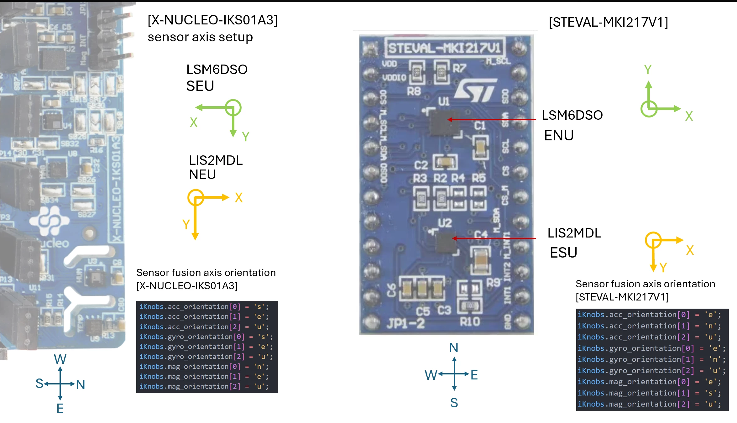

I have been having trouble with finding the correct steval-mki217v1 motionFX 9axis fusion Sensor orientation: NED, ENU, SEU, NWU. the only resouce I had was from IKS01A1 Nucleo eXpansion board. I had tried several combination and had the best combination shown below.
Please feel free to correct what I got wrong here.
Could someonr confirm this sensor orientaion I use on the right is correct as well as how can I determine the north east west south from this shield?
