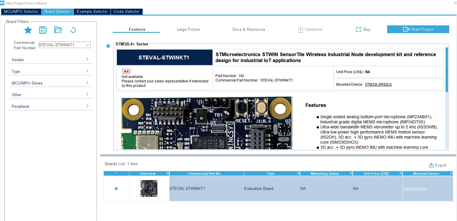

I wish to make changes to a STEVAL-STWINKT1 which I bought, in other words I have to redesign to suit my application. The example projects works fine. I want to know from experts, is there a tool which will help me to write program or copy the example. Or any video which explains the step by step procedure?
Thank you in advance, your advice will help me as this task looks very complicated. If I have to write drivers from the scratch, hope not.

    Hi @Shaun.t​ ,
    Do you also have to redesign the hardware of the board? If so, please take into account any change you'll apply in the general schematic and in particular in the pinout of the STM32L4 onboard MCU.
    Depending on you target application (and on the data acquisition, for example USB or BLE streaming, WiFi, etc), you may start:
    • from the default application firmware, the FP-IND-PREDMNT1: you can find the source .cproject for the bluetooth communication in \Projects\STM32L4R9ZI-STWIN\Demonstrations\Predictive_Maintenance_BLE\STM32CubeIDE\STWIN_PREDMNT1;
    • from scratch by configuring the STWINKT1 board with the STM32CubeMX: here you can find the STEVAL-STWINKT1 board in the "Board selector", for the direct configuration based on the hardware constrains of the tool itself.

    Eleon BORLINI
    Nov 13, 2020 11:36 AM UTC
    Hi @Shaun.t​ ,
    the .ioc file is just the hardware default configuration of the STEVAL-STWINK1 pins, while the specific configurations of the applications/examples are set in the firmware.
    The attached .ioc file is the one I generated selecting this board in the STM32CubeMX tool as described above.
    -Eleon
