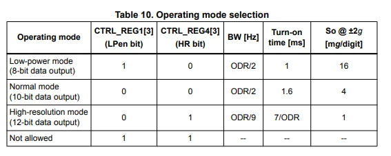

Just for checking, which ODR did you set in reg CTRL_REG1 (20h)? You have to format the data according to this table. Regards
