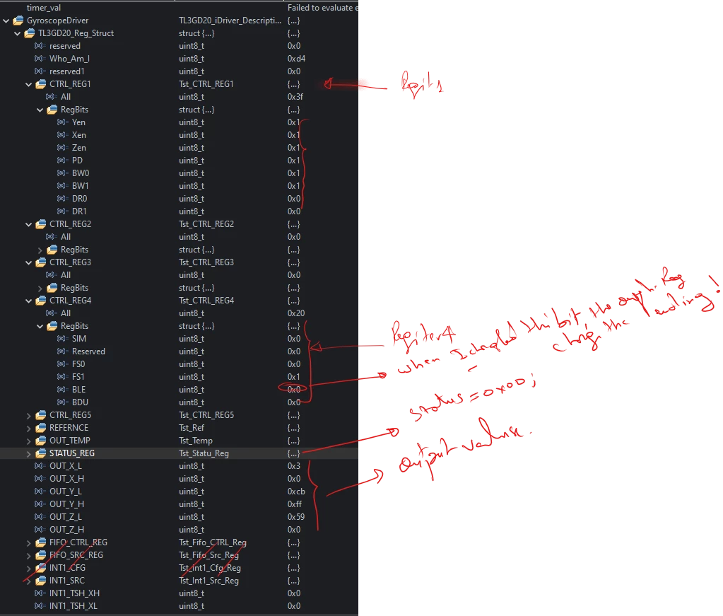

My Gyro TL3GD20 is not working.
  • March 9, 2023
  • 1 reply
  • 1227 views
I am using the TL3GD20 gyro in the stm32F429 discovery board to develop my own driver.
The output registers are fixed and they do not move, always at:
0693W00000aIbfaQAC.pngI respect the 10 ms second before powering up.
I activate the x y and z axis and set the PD register. I also disabled the high pass filter.
I am wondering how to test that the gyro is working. do you have a method to share with me, please?
I expect to have the output registers moving if I rotate the board. Despite the values, in the output register, I have to see something in those registers before starting the conversion..
Here is a capture to see how I am configuring the TL3GD20 gyro:
Thank you in advance for help,

Hi @NSemrHomeInit​ ,
To read the gyro output you need to properly set the register 20h (CTRL_REG1).
For example you can write 20h to Fh and then rotate the sensor and acquire the output, you then have to multiply the output value by the sensitivity value according to your FS (you can set it in reg 23h) to have it in mdps.
Also I suggest you try one of our new sensors for better gyroscope performance, for example you could look at LSM6DSV16X.
