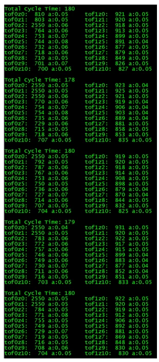

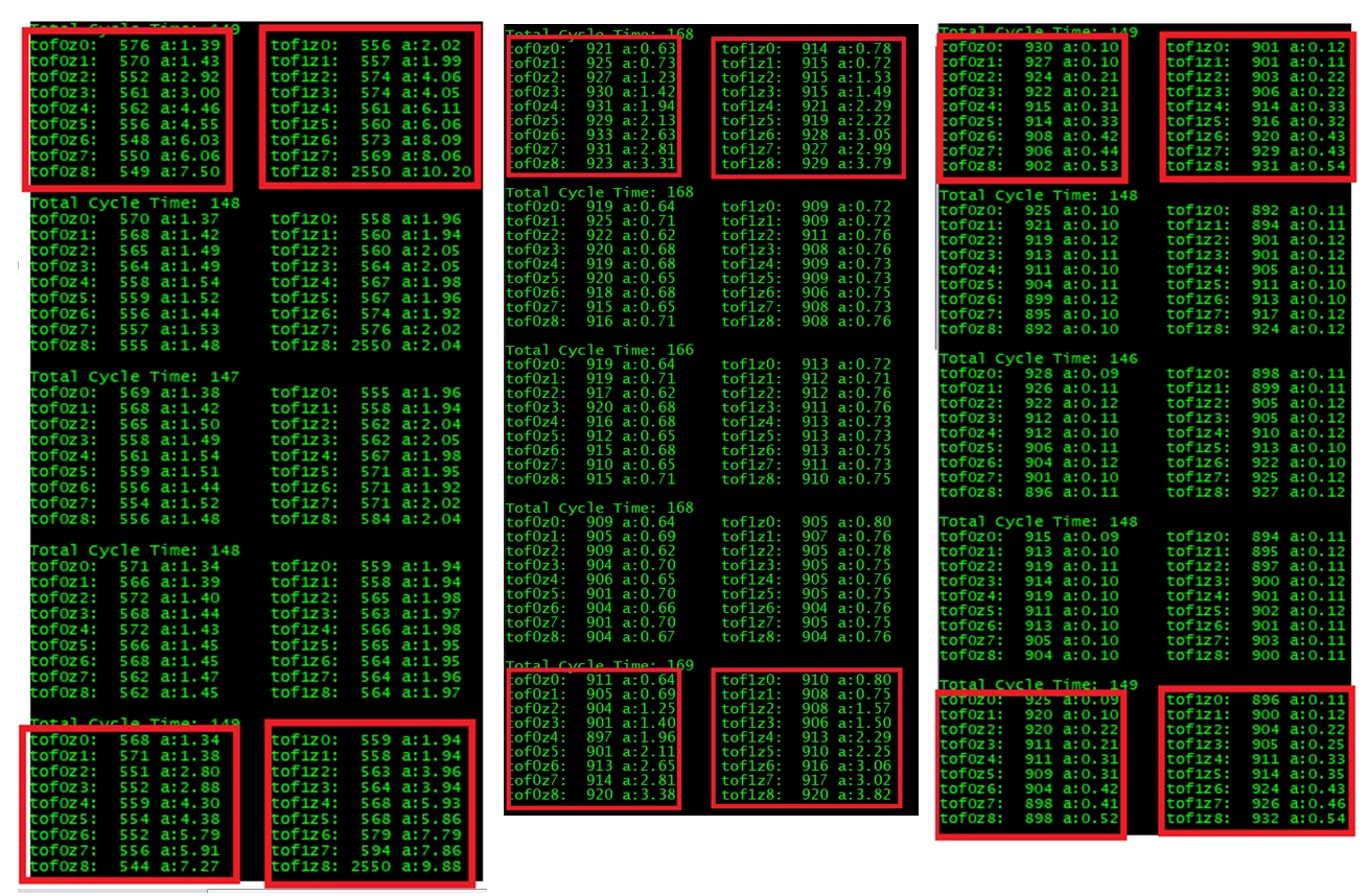

In the last week I devoted myself to study the example application written by ST for the ToF VL53L1 (VL53L1CB).
I was interested in being able to better understand the MULTIZONES_SCANNING mode. In the example, the field of view of the ToF is divided into 2 zones. Based on this, I am attempting to write an application similar to ST's 2D LIDAR. I would like to divide the FoV of the ToF into 9 zones.
At first I thought I had succeeded, but lately I noticed that periodically, some zones detect a particular high ambient value. The curious fact is that this "anomaly" of the ambient value seems to depend on the number in which the field of vision is divided. For example, if I divide it into 10 Zones instead of 9 I don't run into this anomaly. If I divide it into 8 I encounter the anomaly again, but it appears in a reduced form, but more frequently. In the most interesting case, the one in which I divide the FoV into 9 zones, I register ambient values ​​that are about 5-6 times the value recorded by the other measurements.
In a terminal I printed the measurements and above all the AmbientPerSpad value.
Case 9 zones:
0693W000005AWTtQAO.pngCase 10 zones:
0693W000005AWP8QAO.pngAs can be seen in the 9-zone case, the Ambient value is altered by 5 times every 3 measurement cycles. I posted 3 tests done in 3 environments with 3 different lighting. the factor 5 is noted in all 3 cases. Instead in the case with 10 zones, no alteration occurs.
What can be the cause?
If you need more information I can try to be clearer.
Thanks in advance,
Vincenzo

The L1CB can automatically sequence between 4 zones, but if you want more zones you can change the zone setting during one range, and they will take effect on the next range. Care must be taken to change the zone dimensions for range N after the range N-1 has begun but before range N starts.
A good bit of expample code is in the 2D lidar demo that can be found on ST's web site.
STSW-IMG017 - 2D LIDAR using multiple VL53L1X Time-of-Flight long distance ranging sensors
(This example uses 9 sensors, and 13 zones per sensor.)
This example uses the UltraLite driver, but you can do the same thing with the other driver although the calls to change the zone are different.
I'm assuming this is what you are doing.
If you have a coverglass, the amount of crosstalk can change quite a bit with the different zones.
But it would be a small matter to change the calibration data between ranges.
I realize i did not address your ambient light question - basically i cannot explain that.
Can you run your experiment in a place were there is no sunlight - so the Ambient should be near zero.
