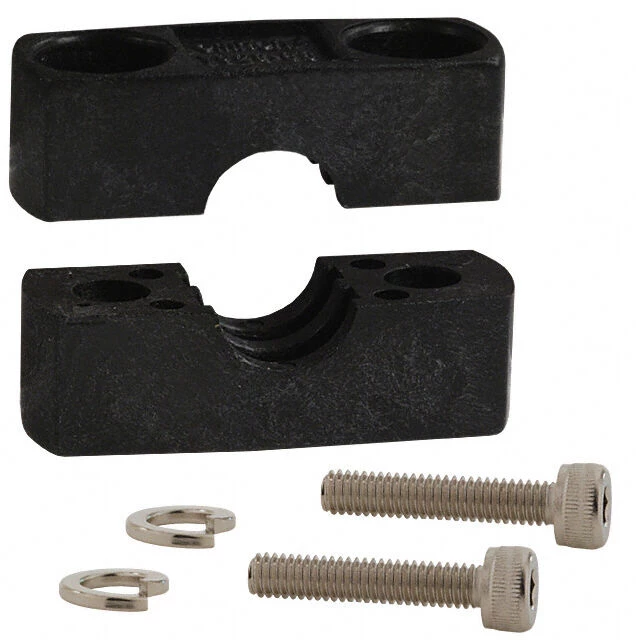

just one idea of a very simple clamp for attaching to a tube/pipe:
https://www.digikey.co.uk/en/products/detail/omron-automation-and-safety/Y92E-B8/664701
easy to make or 3D print; maybe you can even find one to buy off-the-shelf ...

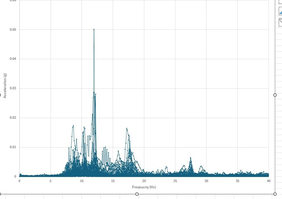

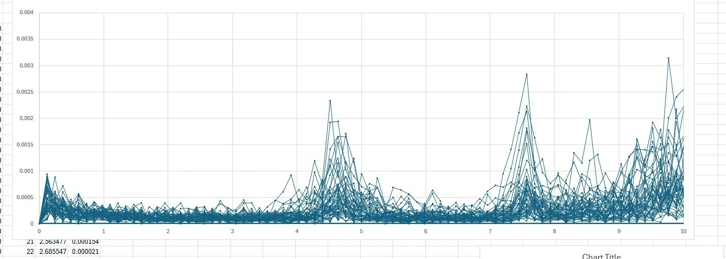

This is from the Sensor Tile Box pro, how accurate do you want the frequencies,  also FFT work in steps, the most likely solution is mid step.  (Central Limit Theorem beats you every time)
Same sensor, the absolute peak at 7.5 is really rare, like this is the first one I have seen and I have done this for a long time.
Are you looking at frequencies with the tube in place or just the tube.  Either way one would normally do a Finite Element Model
