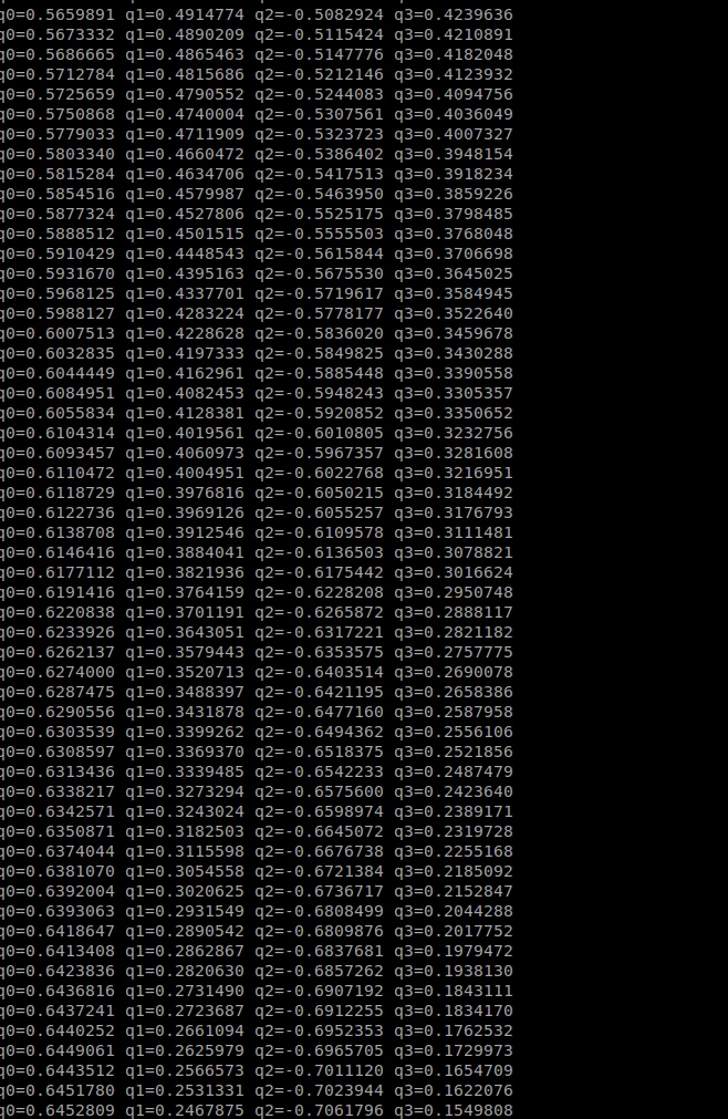

Hello I have previous implemented the motionfx to get quartenions using lsm6dsl and lsm303agr over i2c, and everything was working great. Now I changed the sensor lsm6dsl with lsm6dsox who is communicating over spi with stm and lsm303agr in mode2(spi-to-i2c). I have configure it the same way as it was working with the old sensor. But now If I leave the board still on the table not moving, the quartenions are changing from -0.9 to 0.9 like there are incrementing. I tried to change the orientation,data_rate,sensitivity, but nothing. I checked the raw data from the sensors and seems ok,values are stable, but still getting weird quartenions. I can confirm that read and write are working for all sensors.

    Hi @suads​ , since the lsm6dsox is (almost on all parameters) more accurate than the lsm6dsl and the X-NUCLEO-IKS01A3 shield has a lsm6dso onboard, i believe it is some issue coming from the synchronization of the device, resulting in a misalignment on the output signals that are mixed together in the sensor fusion of the MotionFX library. This may result in an "integration" error that increase progressively the quaternions value without a real movement. How are you synchronizing the sensor output data? I suggest you to check the X-CUBE-MEMS1 Example in Projects\STM32F401RE-Nucleo\Applications\IKS01A3\DataLogFusion folder. Regards

    Hi Eleon, to sync I m using Sensor hub trigger signal setting lsm6dsox_sh_syncro_mode_set(&dev,LSM6DSOX_XL_GY_DRDY); and setting the sh_data_rate to 100hz, and I m setting the output data rate from all sensors to 100hz. Here are my settings:
