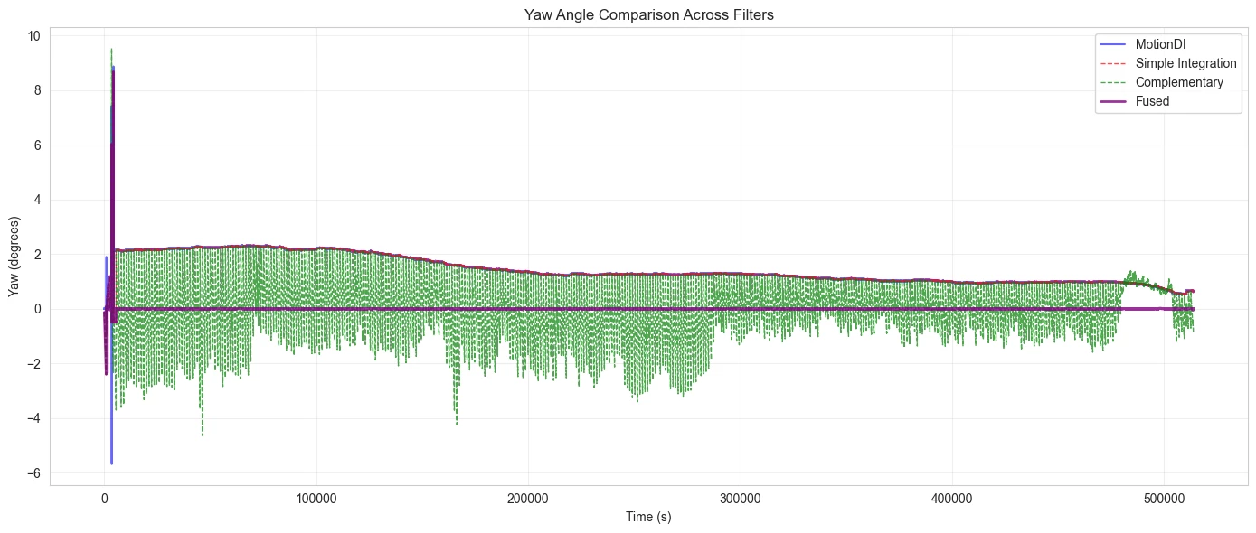

Since it has been awhile since I posted the question, certain things have changed. However, the goal is the same. We would like to use MotionFX or MotionDI to detect orientation changes on a fixed pole (about 1m) that is standing outside near a busy road. We would like to track altitude and zenith changes after reboots (we restart azimuth on each power cycle). This is for a larger project where we will eventually have many of these fixtures that have multiple sensors to perform multiple tests. One of tests is to detect whether wind/turbulence or an animal or ... has moved the fixture. We would like to be able to tell that any type of movement has happened. Not in real time, we can wait up to four hours before responding, giving us a good "validation" time to compare with drift or ... We do, however, would like to be able to detect both slow movement (about 0.016dps to 1dps) and fast movement (above 1 dps) up to 5 degrees accurate for altitude and zenith, and up to 10 degrees accurate for azimuth.
The idea was to, on startup, take a reference quaternion and track angles from there. We hoped that using motionFX we could mitigate the drift in azimuth (that the Kalman filter would "recognize" the drift and ignore it for a large part) and would help us to detect changes. However, as mentioned above, MotionFX sometimes gives us worse performance than a simple complementary filter on mitigating the drift.
Currently, we have MotionDI set up with a quaternion reference and have a simple complementary filter running in parallel that resets every `n` minutes so that we can keep detecting true changes for azimuth.
Using this technique, we have been able to get azimuth a lot more stable:
However, we were still wondering if there is no better way to do this using just motionFX or just motionDI? It seems weird that, even using parameter optimization, we can not get overall good results for tracking changes in a stationary system.
Do you have any idea why this is? Any tips?
