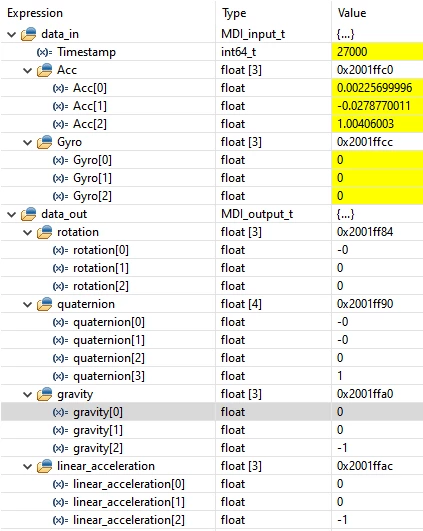

I'm trying to use the MotionDI library for a dynamic inclinometer application. My IMU is the LSM9DS1. The returned data from MotionDI_update() is shown below:
0693W00000Bczh6QAB.pngThe values for rotation, quaternion, gravity, and linear acceleration never change, even when the IMU is moved. I initialized the MotionDI library according to the sample code in the documentation:

OK, the data are OK. I'm able to get correct output values from MotionDI library using your data.
I checked you code and I see you call MotionDI_setKnobs(ipKnobs); function without settings the knobs parameters.
You can check application example in X_CUBE-MEMS1 package.
You should read the default knobs settings and the modify the only settings you need.

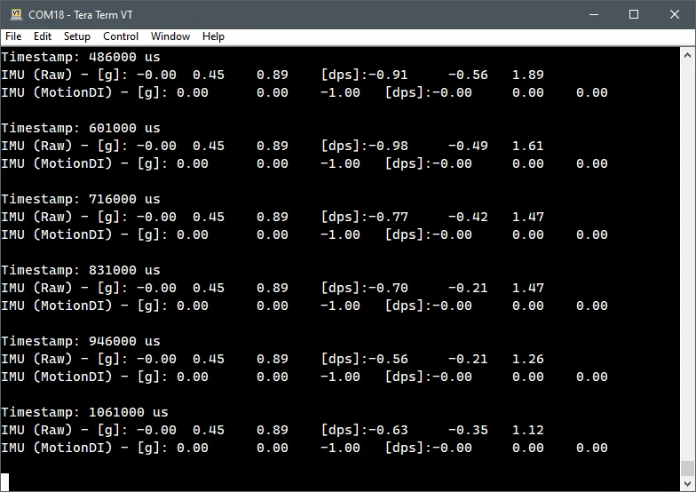

By datalog do you mean the output on the serial monitor? If so here it is, with the IMU tilted 45 degrees:
Jul 16, 2021 7:17 AM UTC
By datalog, I mean text file (ideally csv) in which you record like 30 seconds of the accelerometer and gyroscope data which you pass to the library.

Jul 19, 2021 8:06 AM UTC
Thank you for the datalog, the data from accelerometer and gyroscope looks good, but your update data rate is low. I see the update data period is about 115ms.
Can you please update your code to increase the speed so the period is ideally 10ms.
