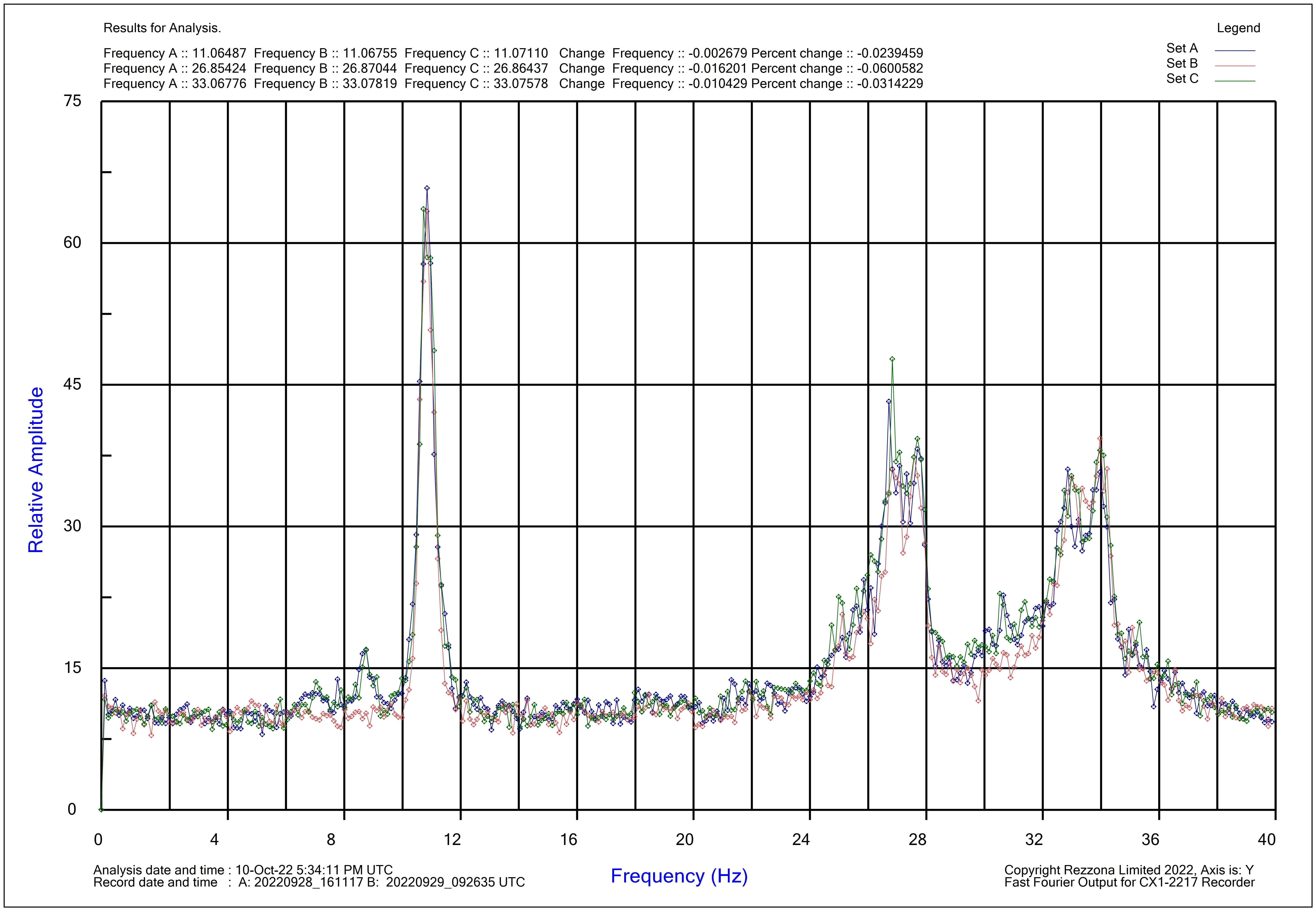

  1. 0693W00000UnpKjQAJ.pngOn loading the firmware to the MKI 109, the ST Cube Programmer yielded a unique serial number for each of the 109 devices. However, I can not get the ST Cube programmer to reopen the connection once the firmware is updated. This is a problem because we are using two MKI210 devices with a single NUC. If the NUC reboots the devices can swap Port numbers, so I cannot use the Port Number as a unique identifier. Is there a way to read the serial number from the MKI210 device with C# code at the time I boot the computer?
I enclose a results set, which are good.
