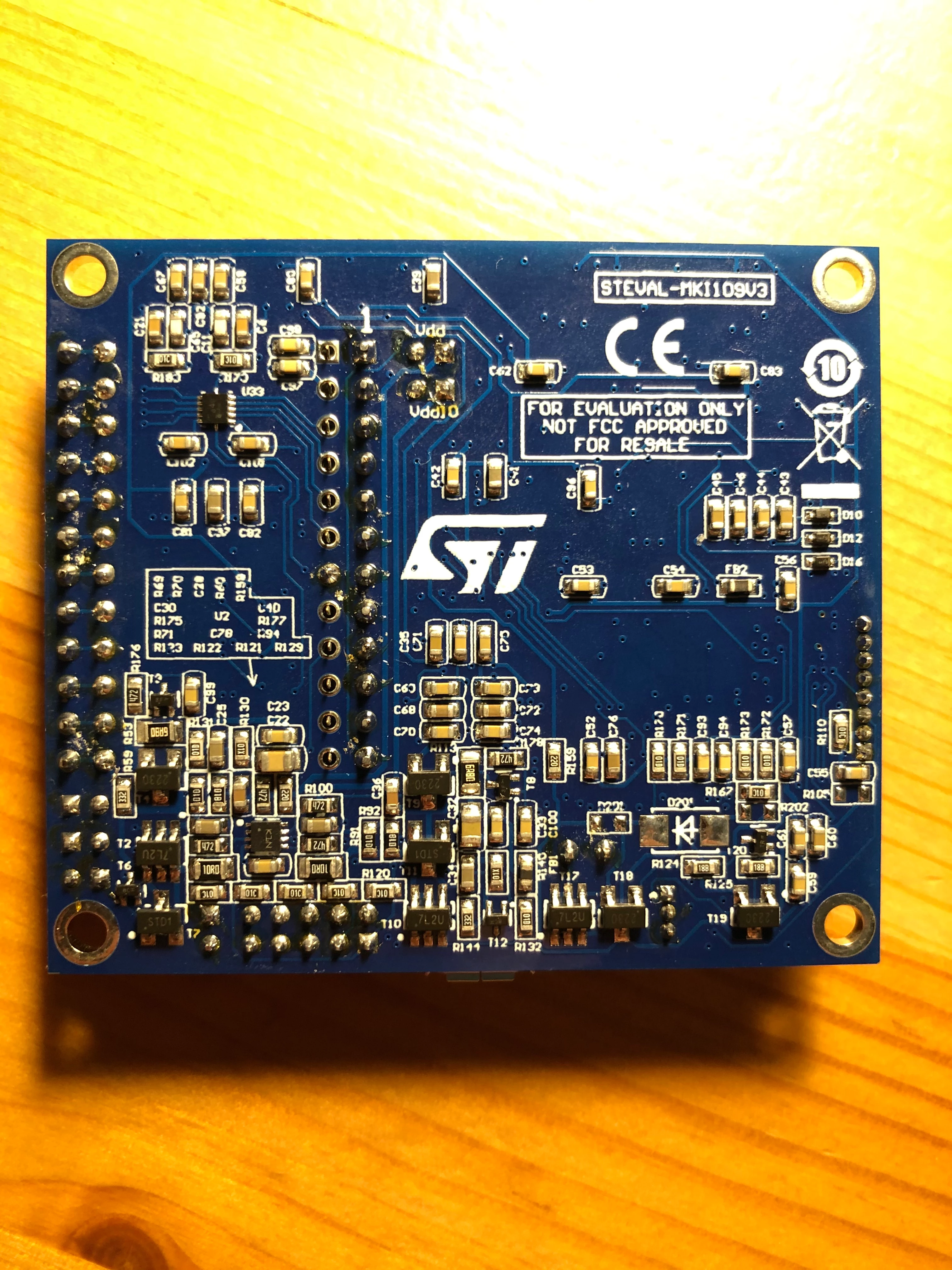

Please can someone help me, I am quite new to this hardware.
I have a MKI109V3 eval board and trying to test MKI197V1 LSM6DSOX adapter. I've downloaded the Windows software package and installed Unico V9.8.1.0 and the COM port driver V1.5.0. I've also updated the firmware of the MKI109V3 to V3.6.36 via STM32CubeProg.
In Unico, when I try to select device MKI197V1 I receive this message:
ERROR: The adapter board has not been recognized.
The WHO_AM_I register does not match the device selected.
I am unsure why I'm getting this error message. Any help would be much appreciated.
Many thanks,
Liam
    Best answer by LTray.1
    Never mind, I found the issue:
    half the adapter pins on the reverse side weren't soldered to the board :grinning_face_with_sweat: .
