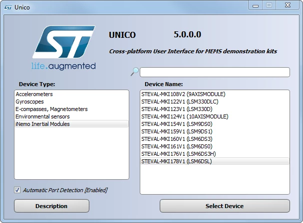

I have a MKI178V1 attached to the MKI109V2 evaluation board.  When I go to collect data using the Unico GUI, my adapter board is not on the list of devices. Can I add my device somehow?

    Can you please download the latest
    http://www.st.com/content/st_com/en/products/embedded-software/evaluation-tool-software/stsw-mki109w.html
     . The STEVAL-MKI178V1 is available, see screenshot below.0690X00000606ZBQAY.png
